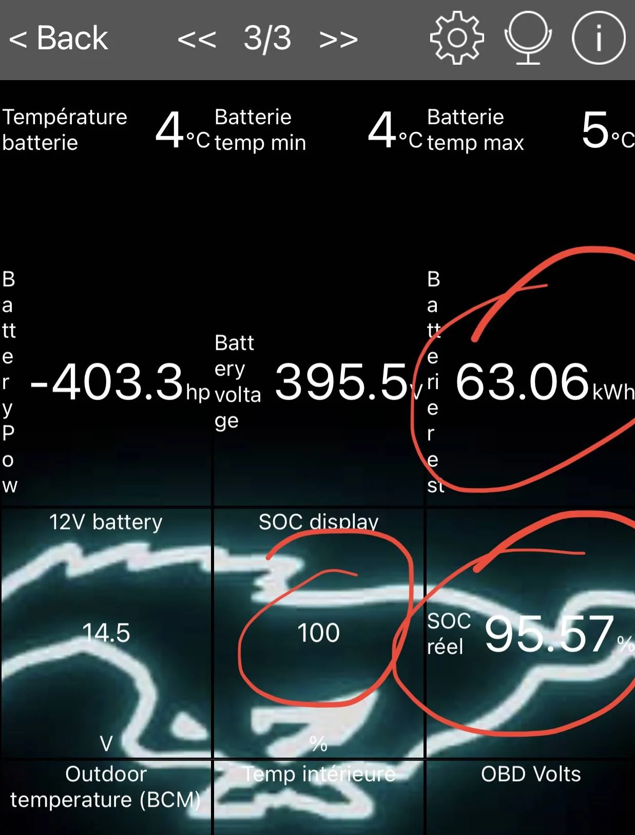

I just found that data in Car Scanner from a member here but that doesn’t seems accurate. I wonder what you car shows with a 100%.
I wanted to see if I got a 2 kWh increase from 68 to 70 kWh with the 21P22 update but with a 100% SOC, my real SOC is still between 95 and 96% but High voltage energy to empty is just 63 kWh. 96% SOC would mean a total battery capacity of 65-66 kWh as opposed to 75.7 kWh.
Car scanner user, can you post your results, I would like to compare.
Thank you!

At 4ºC battery temp that could be a realistic figure. It could also be calculated based on usable and not actual which would make sense for the battery temperature.

I was thinking the same thing. You need to measure it in warmer weather to get a more realistic measurement; the cold is reducing battery performance.
