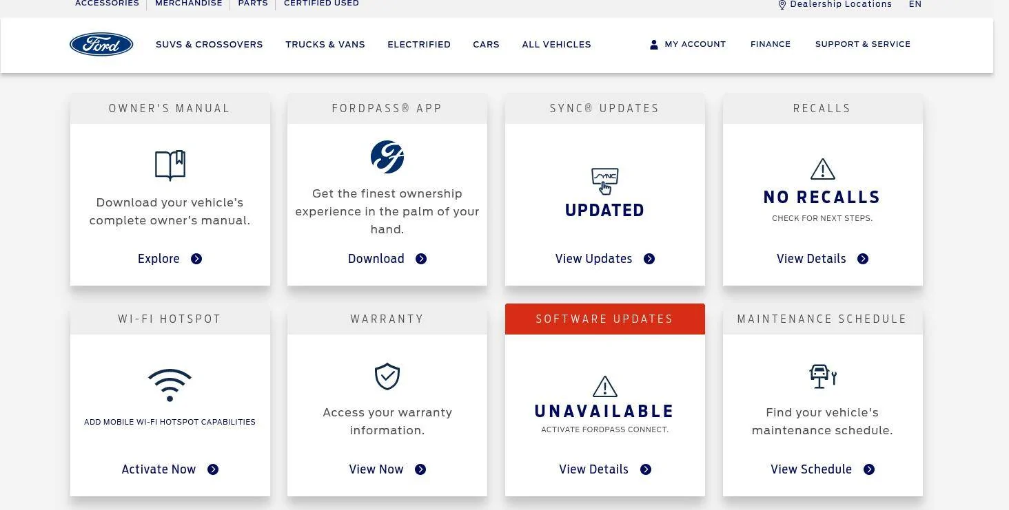

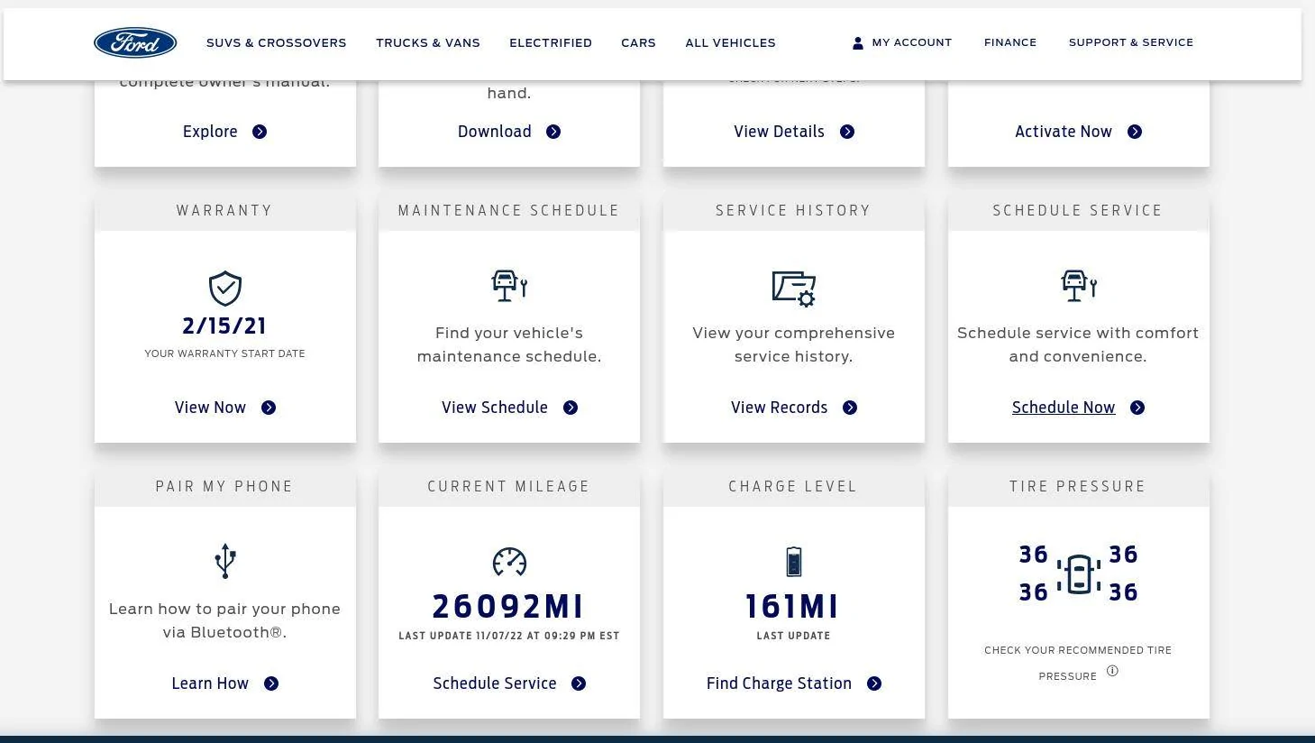

I put my new rides (yet to be delivered) vin in my Vehicle Dashboard on Ford.com website and it just appeared in my phone app when I logged on.
Does your Dashboard look like this.
Ford Mustang Mach-E I am beyond irritated. FordPass app will not work Screenshot 2022-11-07 9.46.23 PM
If not I would delete the Vin out of your Ford.com dashboard, put it back in and then try loading the app.
For a car not activated yet it looks like this.
Ford Mustang Mach-E I am beyond irritated. FordPass app will not work Screenshot 2022-11-07 9.51.47 PM
