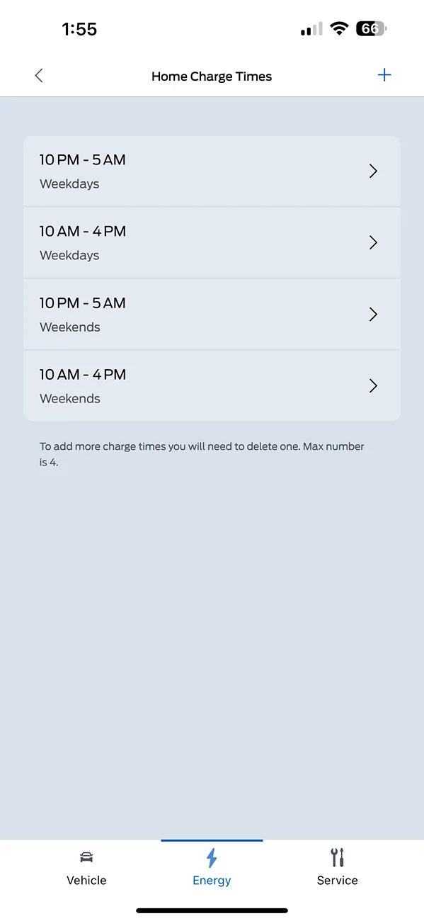

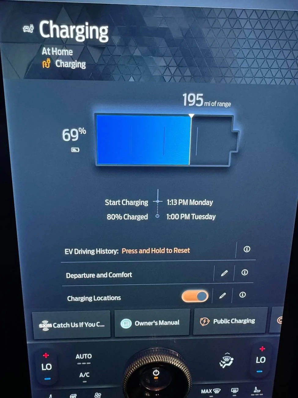

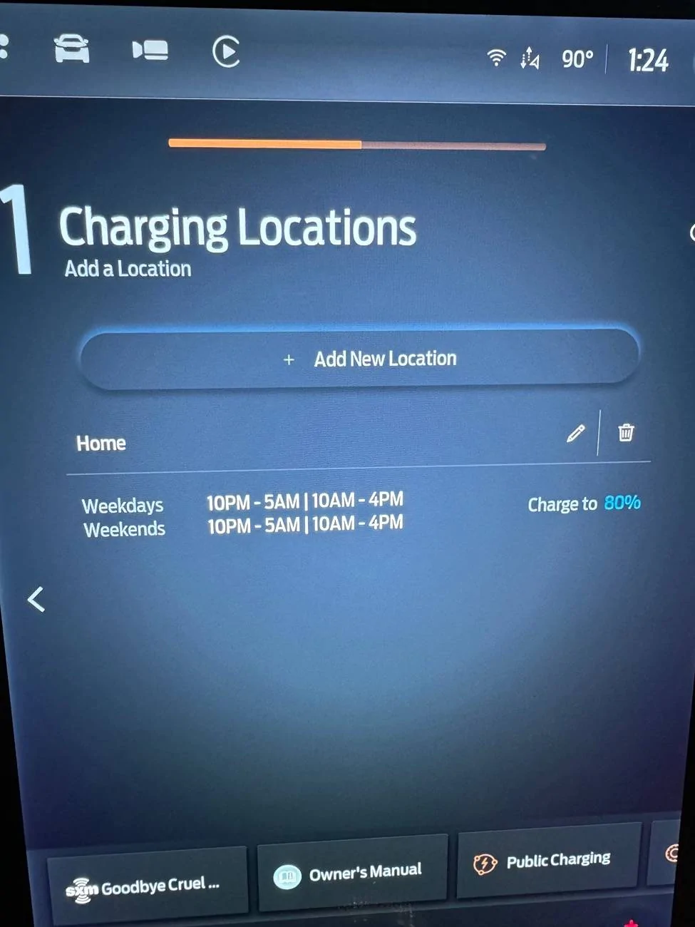

I have had an issue with my Mach E ignoring my preferred charge times at home. I deleted all locations, and added my home as the sole charging location, with the preferred windows being 10AM - 4PM, and 10PM to 5AM. The target is 80%, and I have no departure and comfort settings. This was all set up in the car (not through the app), but the car is still happily sucking my expensive California electrons off the grid after 4PM unless I manually stop it. I cannot find where there is anything that I can toggle to "charge when plugged in" or conversely "use preferred charging time" other than the charging locations toggle in my screenshot attached. I should add that it has worked occasionally in the past, but not with consistency. Thanks for your insight in advance!

The MME will calculate how long it needs to charge when you plug it in based on the EVSE power available. If it needs longer than your charge window allows, it will start charging immediately ignoring your settings. This is very common if you charge with L1. It will stop charging when it knows it can get to your target charge in the window and then start up again when you get to your charge window and finish the charge during the window.
In your case, since you have two charge windows, it may do its calculation only on the next available window and not consider the 2nd window. Also, if it doesn't seem to act as above, you might try adding your windows in the other order and see if it clears it up (ie. add 10AM-4pm first, then 10PM-5AM second). It wouldn't surprise me if there was a glitch in the software ;-)
It does this to make every attempt to get to your target charge SOC by the end of your charge window (with some buffer). The easiest way to stop this from happening is to use a smart EVSE that won't allow it. You won't hit your SOC by the end of the charge window (that might be ok) and it will start up and finish in the next window. You can also drop your target charge SOC so it will fit in your window for that day but that is a manual exercise and you need to remember to adjust it back up for the next window.
I like the way Ford prioritizes the target SOC over the charge window since this can affect the next day's drive, but it is not documented anywhere.
