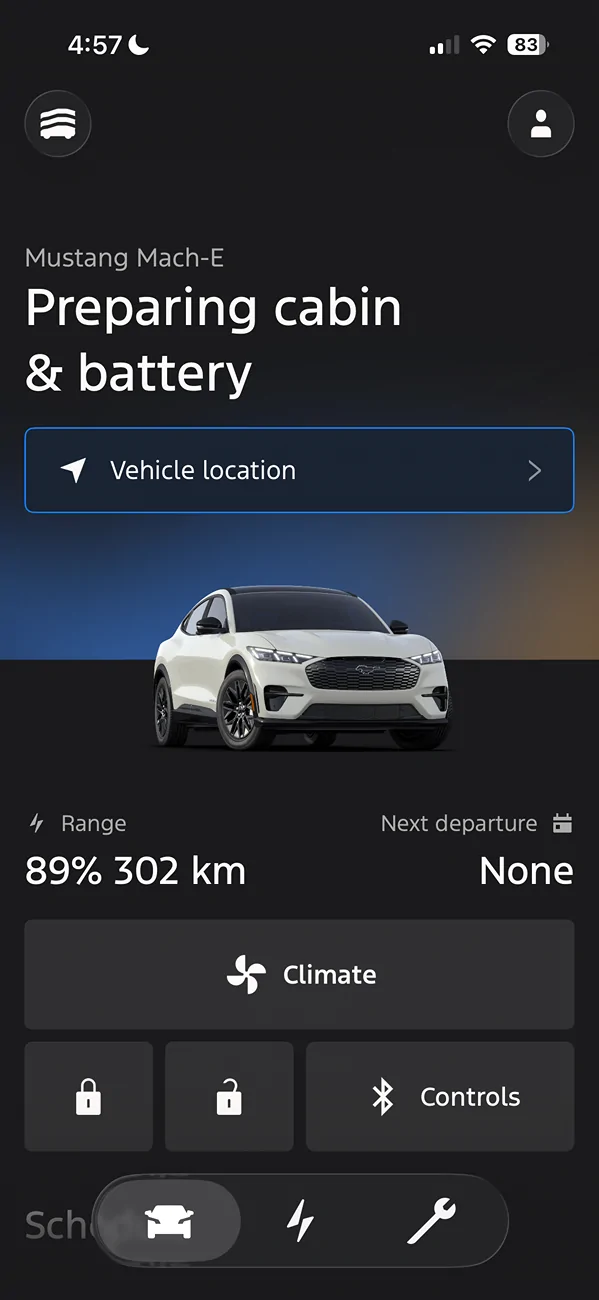

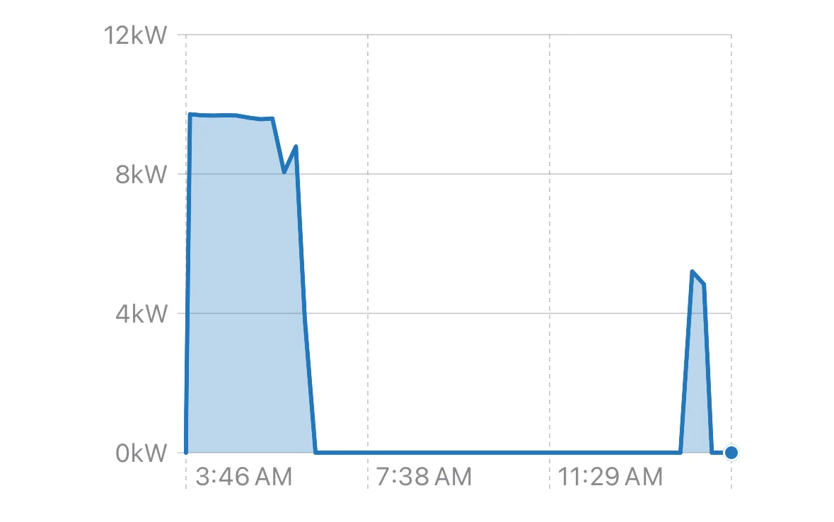

Coldest day in January so far where I am that I have data for was Jan 24 where the low was -32.6°C and the high was -23.3°C. I was plugged into a 120V outlet at work. Picture below.
