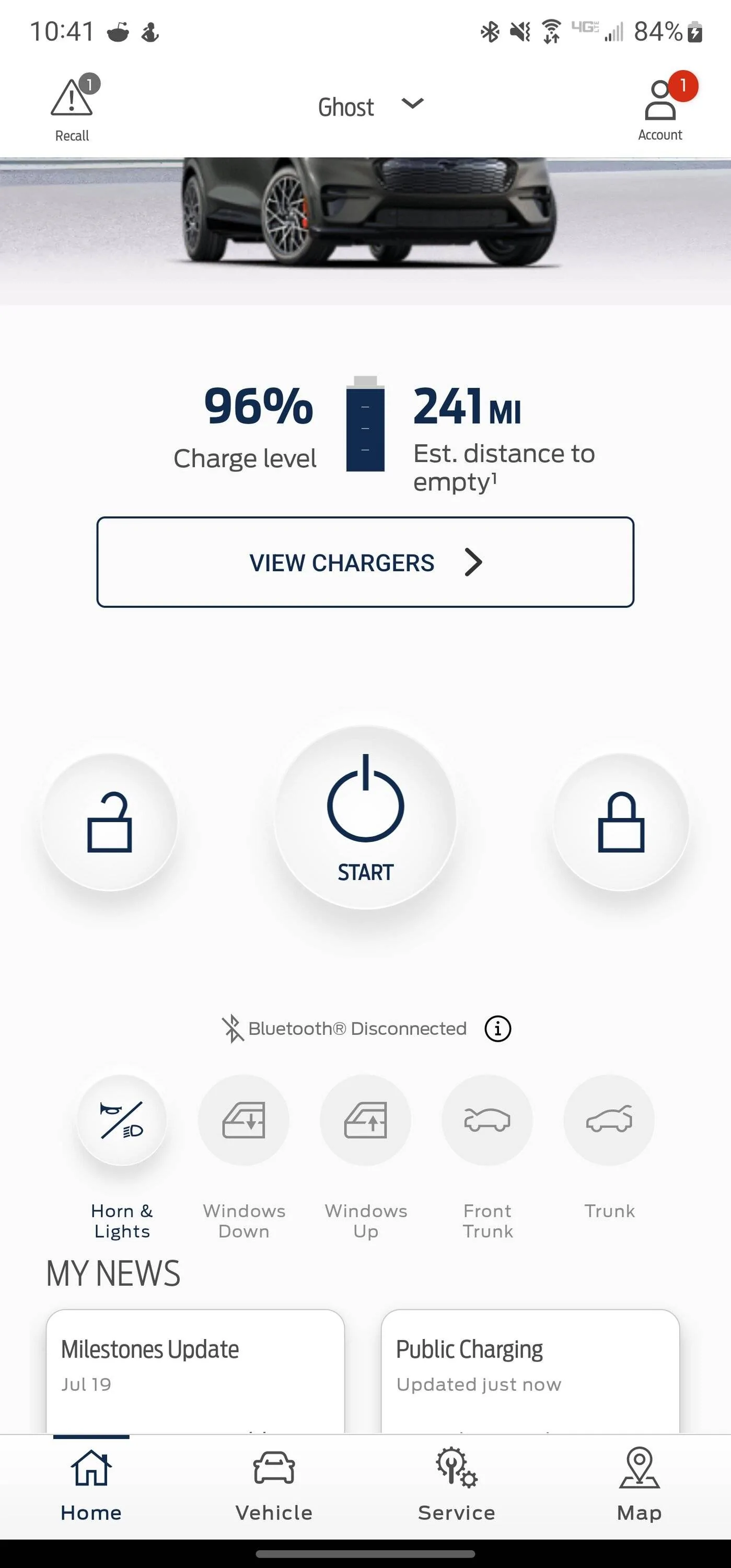

Since I've gotten some OTA's and FordPass updates, I don't see the setting to remote start if not plugged in and my car isn't doing it when precondition is set and I'm not plugged in. Has it moved somewhere else? Didn't see in my settings and Remote Start is turned on so I can manually remote start but it doesn't automatically do it anymore
I have the remote start button whether or not plugged in, and whether or not connected to Bluetooth. Currently, in this screen shot, I'm not plugged in or connected via Bluetooth.
Ford Mustang Mach-E Departure time Preconditioning  does not work if not plugged in Screenshot_20220815-104102_FordPass
