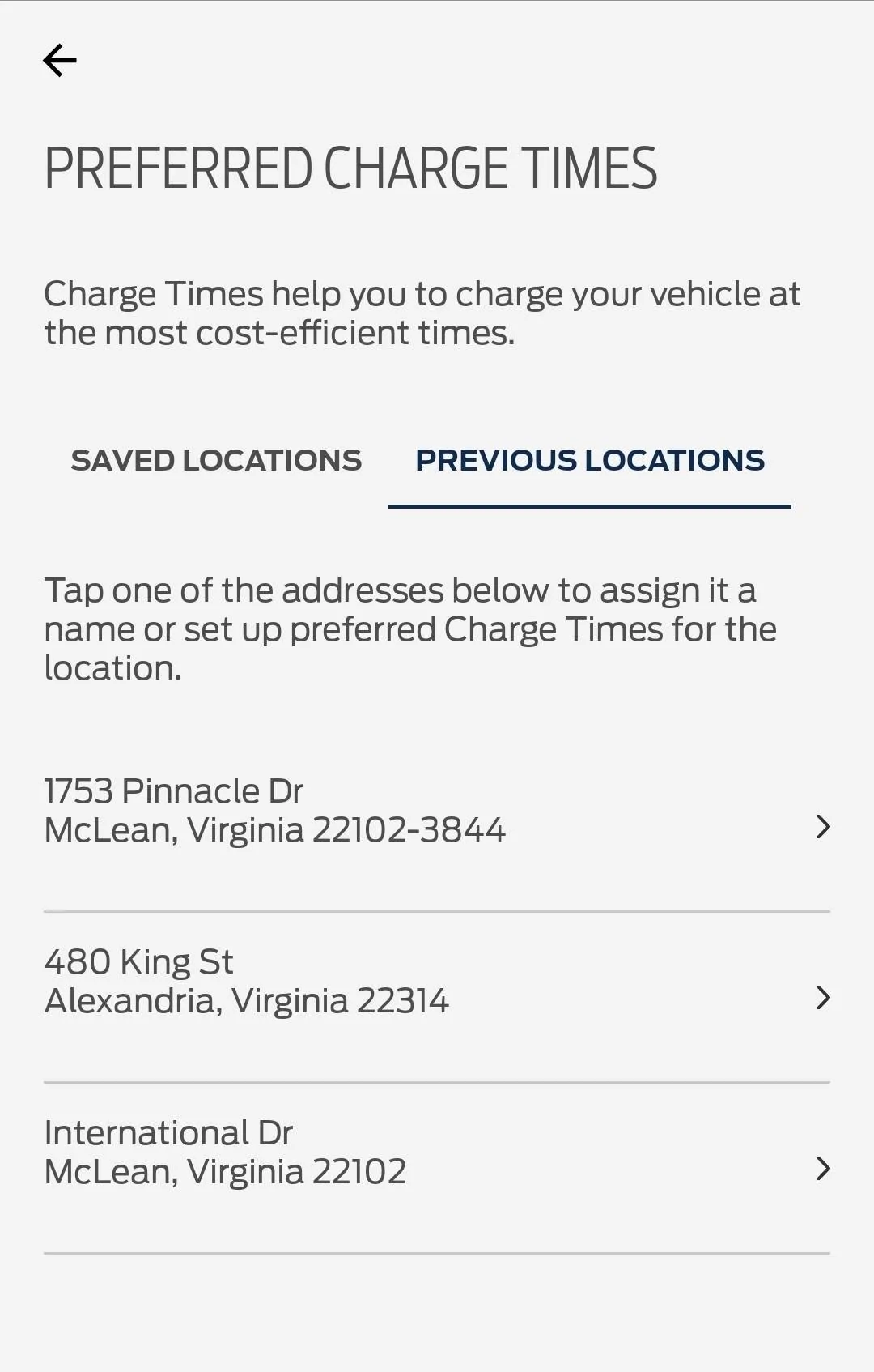

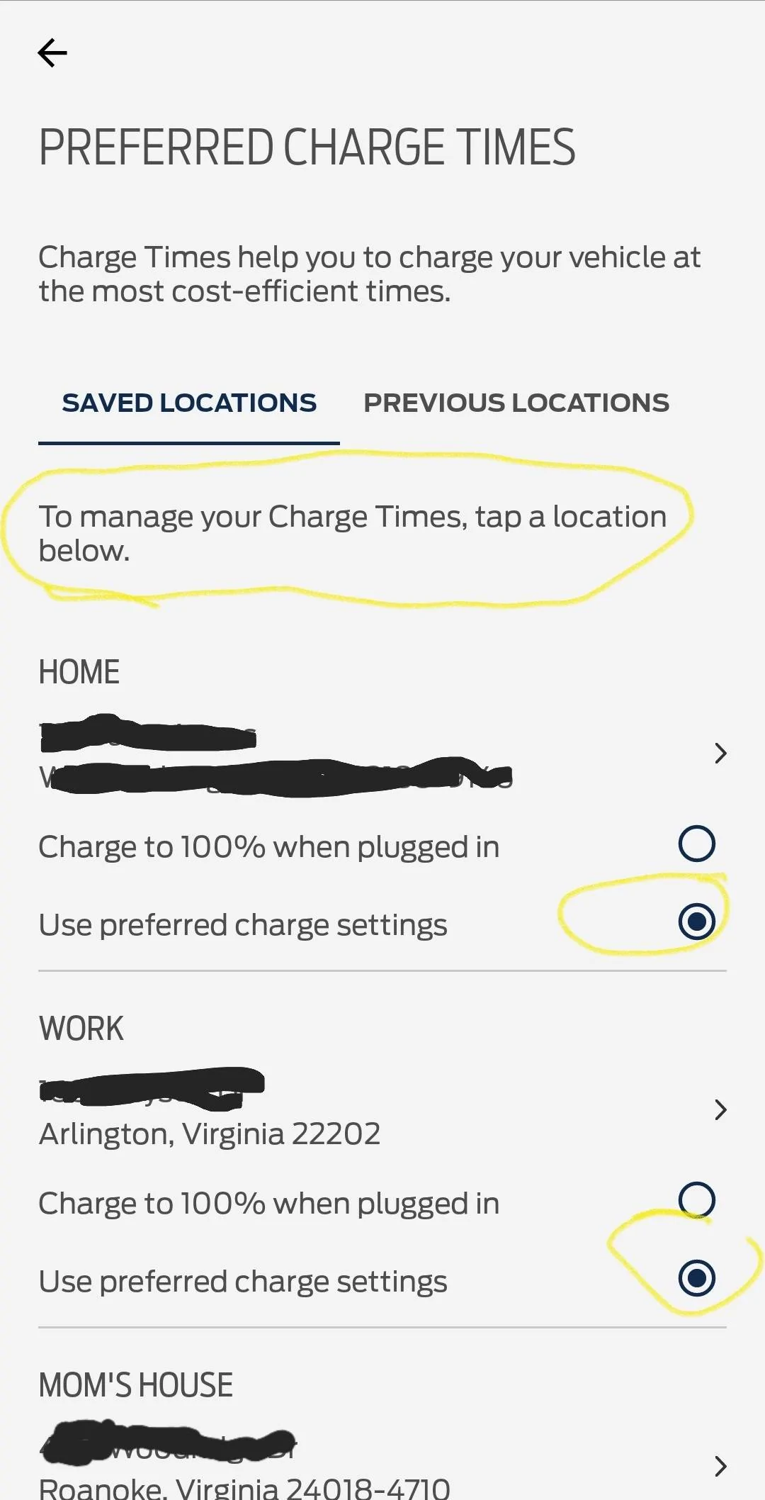

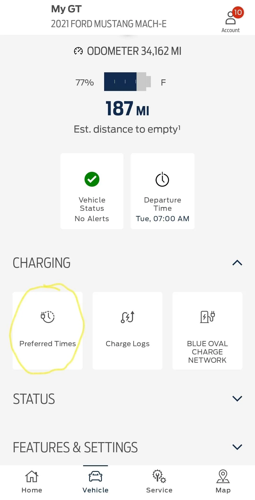

Once you’ve set that up in your car, you can configure the same through FordPass by tapping Vehicle at the bottom, then charging, then preferred charging times, then tap the location to configure the max charge.

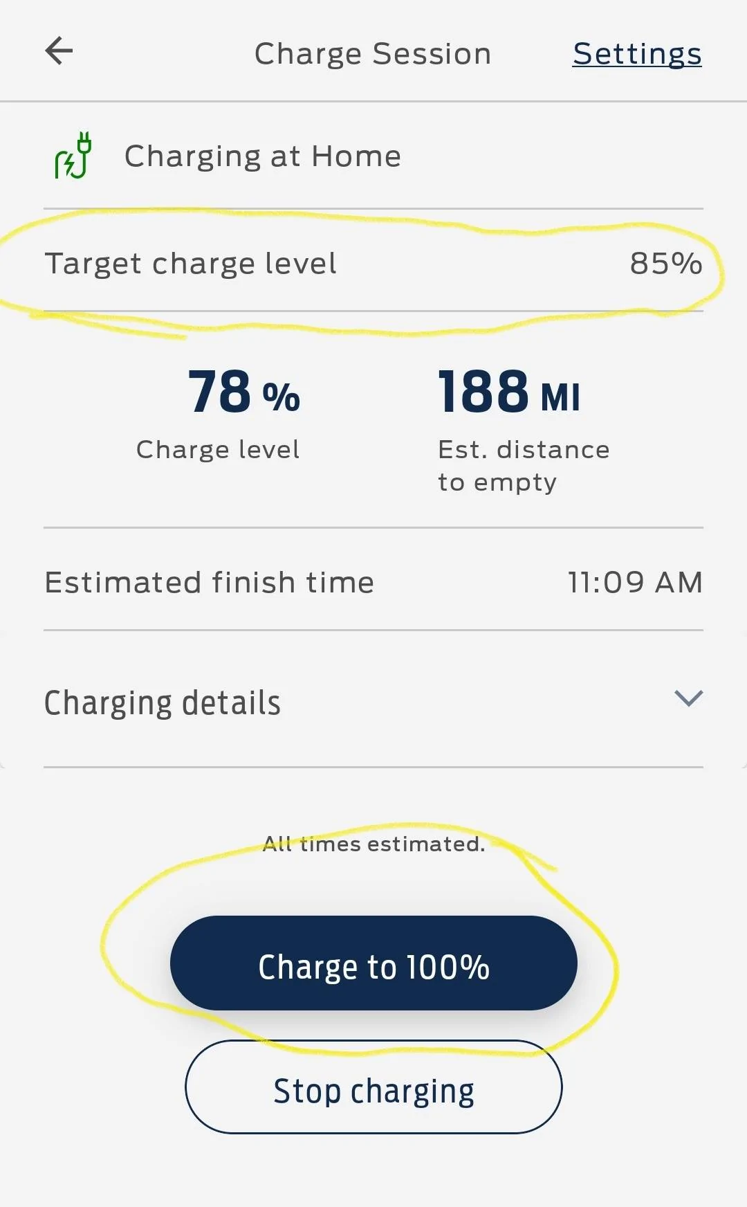

You have to create location and then you can set a charge limit. If you don't do that, it will always charge to 100% unless the station stops the charge.
You can do it in the car, or in Ford Pass. See below:

Thank you. It will not allow me to add a new location...I'm so frustrated! And yes, completely counter-intuitive. I will try again.
You have to charge at a location before you can set it.
