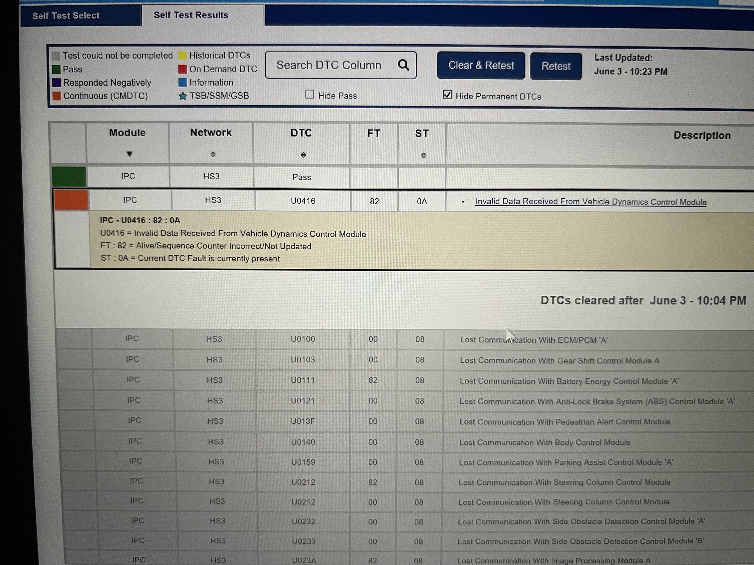

Has anyone ever seen this and or know what to do?
Ford Mustang Mach-E IPC code 161A850A-BDC4-4412-83F5-C66FF57627DD

Did you do all updates in FDRS? I got this after doing all of them and then closed FDRS, reopened and did a fresh network scan and had the, I think, GWM update as available. I may have also reran the PCM update, but can’t rememberer. Ran that, cleared all DTCs and was good!

All updTes have been done. I ran one update and now I have reverse brake assist not available and that dtc now. Not sure what else to do. Damn dealer in this town is horrendous to get in.

Sometimes this happens. Turn the car off, wait an hour and come back. Once things go to sleep and wake back up it clears out little bugs. Sometimes driving the car for 10 minutes works as well. Reverse brake assist is the most common of them that have this issue.
As for the DTC, there's a lot of us who do updates that live with persistent DTCs that never appear to cause issue. I update often and I don't think I've ever seen all green on clear and retest. I always have some DTCs but no noticable issues. 90% of them are comms errors.

Just reran pcm and that dtc u0416 is persistent no matter what.

Turn the car off, open the door, then turn it on again and clear the code with FORScan. That is not an urgent code and is normal after reprogramming something. You can still drive the car without any issues. It will go away by itself after a few key cycles as well.
