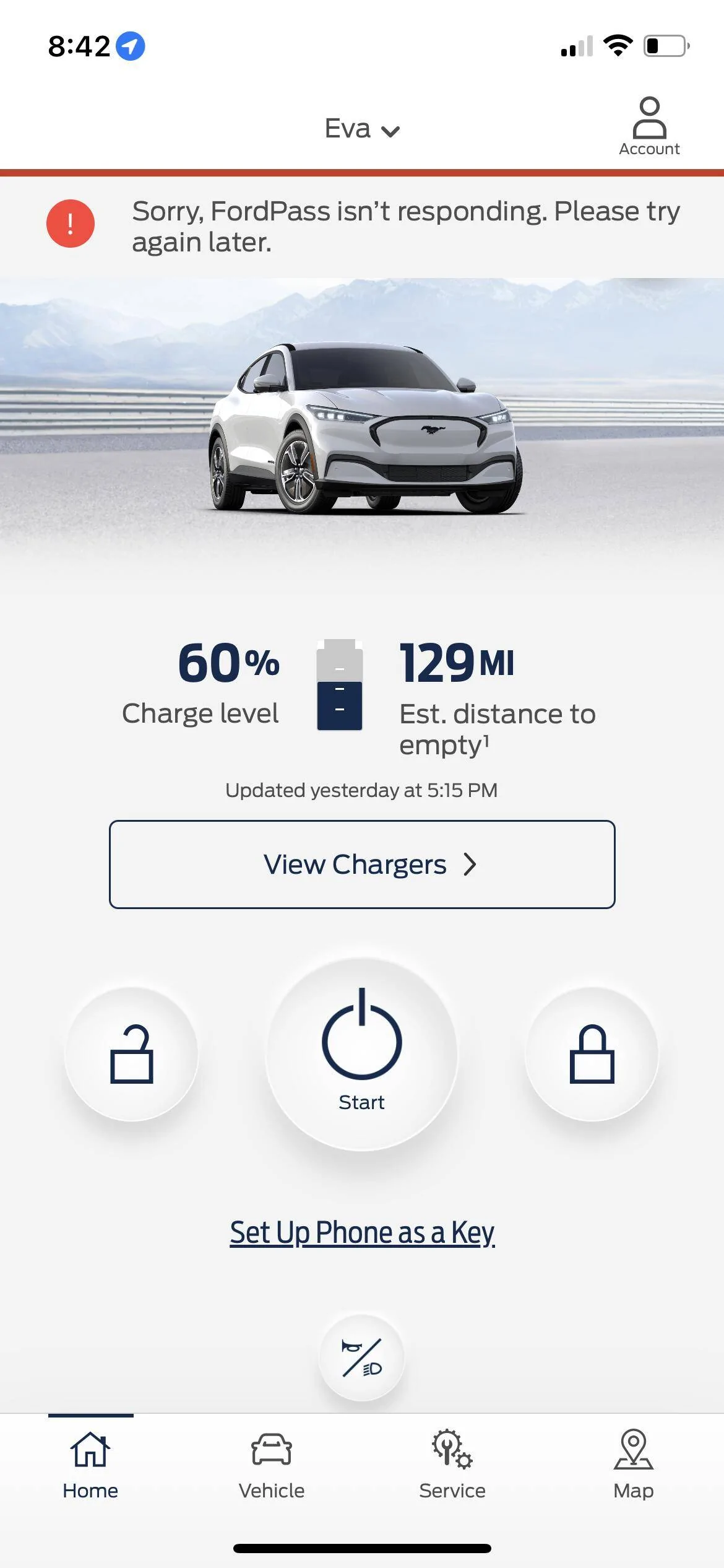

Is FordPass down?

Any luck on this. Just happened to me
Yes, make sure your modem is turned on. If not, turn it on. If you can’t, connect to your wifi and let it set, it will probably connect after a bit.

Connected features when. I select it doesn’t show anything.
Mine did the same. I reconnected my wifi (it some how got turned off) and next morning the modem had connected (overnight) and started updating.
it had been 3 days prior to reconnecting my wifi.

I'm having the same exact problem. All of Friday nothing was updating to FordPass. Then by evening it finally updated. However, I'm back to square one with FordPass not updating once again. Connected Services once again missing. I am connected to my WiFi though.

Sorry to resurrect this, but my Connected Vehicle Services stopped working yesterday. Vehicle location wouldn't update, my Ford Pass settings were out of sync with the vehicle settings (precondition times not synced), and both my wife and I couldn't lock/unlock/remote start from the app outside of bluetooth range.
When I tred to get to the Connected Vehicle Services dropdown in the car, the section is empty. No 2-way arrow icon on the screen.
I decided to delete the app set it up again. Now it won't set up PAAK. I removed the key from my profile in the car's system, removed the key from the Ford Pass App, deleted the bluetooth connection on my phone, deleted the app, restart phone, reinstall app. Did this 3x, still gets stuck when it gets to the step to type in the 6-digit code to connect to bluetooth.
1. Are connected services required to setup PAAK? Is this why it won't work?
2. Any tips on how to get Connected Services working again other than just "waiting"?

Is your car connected to WiFi?
I feel that was the step that started to ball rolling to reconnecting Connected Services.

Yes, connected to Wifi. I tried turning wifi off then back on to see if that would trigger anything, but unfortunately it didn't.

Well, I drove a few hundred miles out of town, and everything is magically working again. Haven’t tried PAAK setup, will do it again tomorrow. Patience is the only option I guess!
