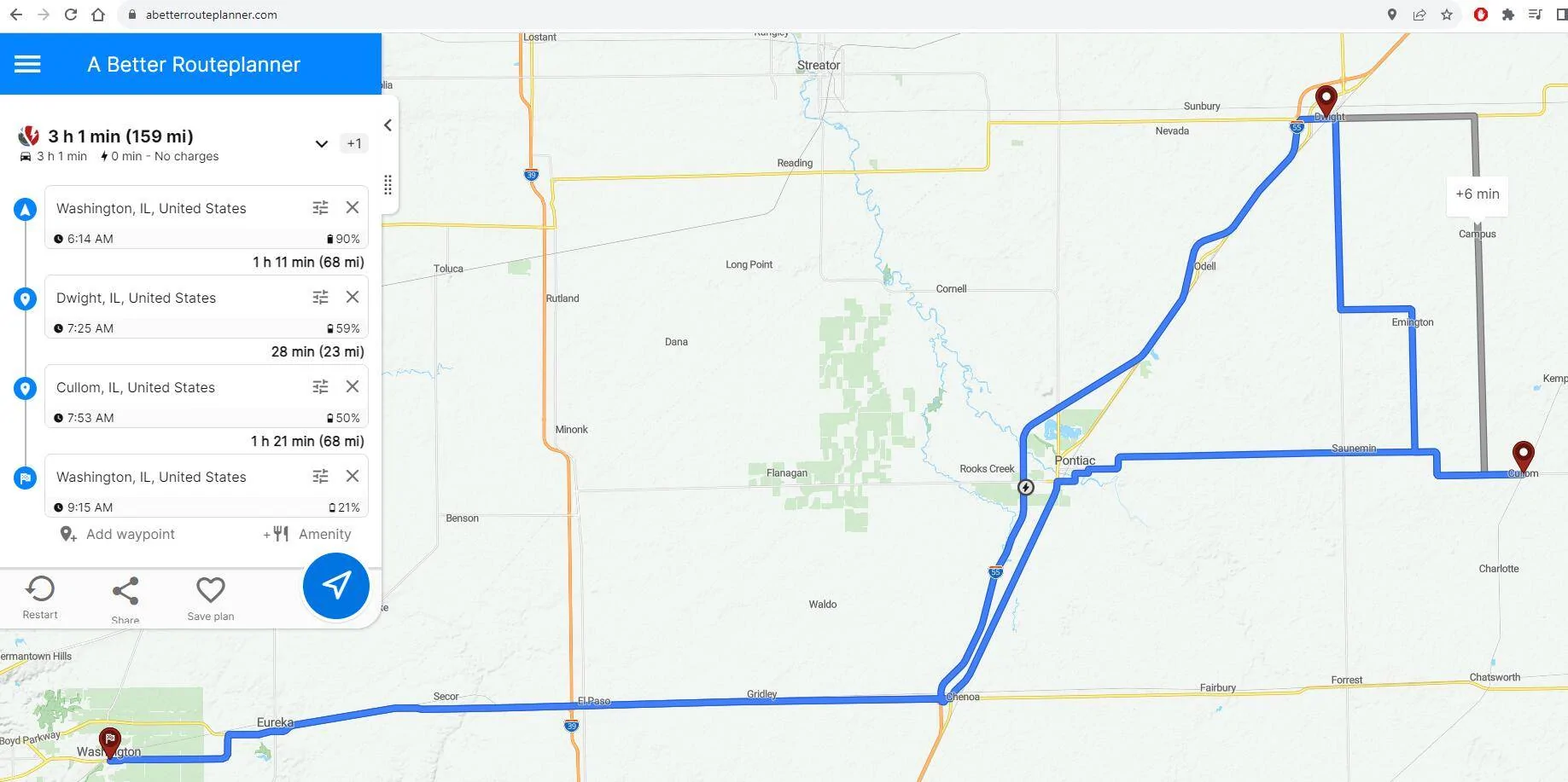

I have found that the Ford navigation system provides very accurate charge levels at destination. It is a little pessimistic, and it assumes I will be traveling above the speed limit, but I like that. I would rather know the worst case scenario rather than an optimistic one. I always arrive with a charge above the original estimate, but within a few percentage points. For route selection, I definitely prefer Google Maps. Except Google seems to want me to avoid some toll lanes, not others, even when I am already on the toll road. The Ford nav sends me down that same toll road, no problem. So neither is perfect.
