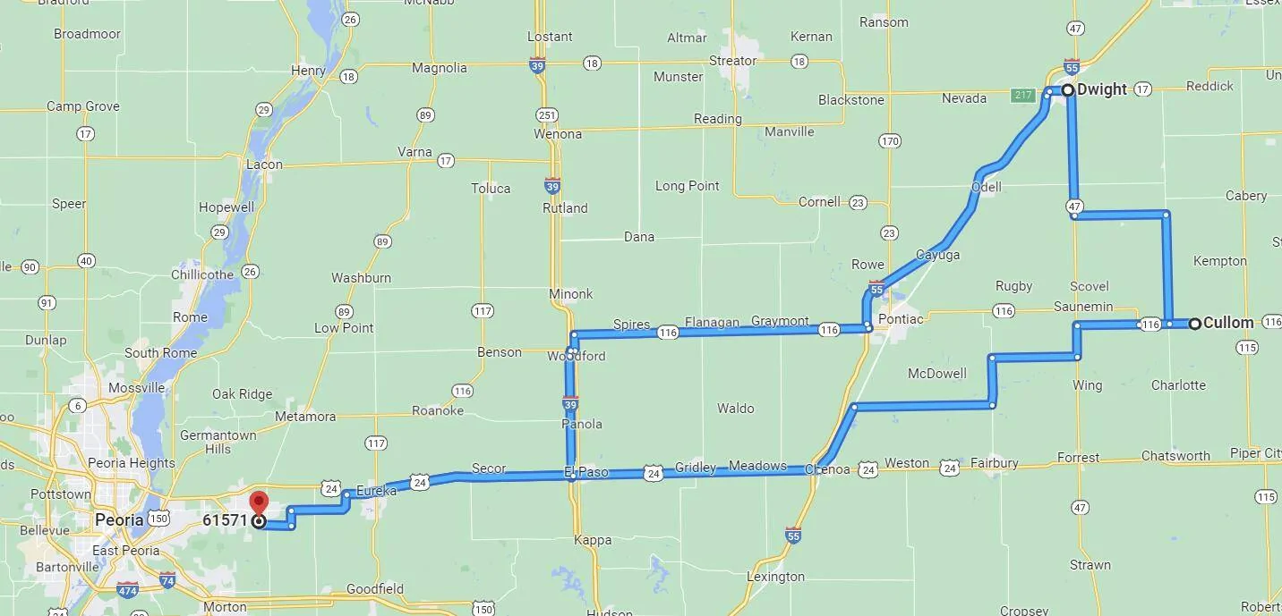

So long story short my 94 year old grandfather is having a birthday dinner in Dwight IL. I need to drive my MME from Washington IL to Dwight IL then to Cullom IL and then back to Washington IL.
This trip is just over three hours and miles traveled will be right around 166 if everything goes according to plan.
So if you haven't already figured it out I'm new to this. So my question is will my MME GTPE travel this route on a singe charge with 2-4 passengers and of course doing normal car stuff like running the AC, listening to the radio, charging devices, ect?
Here is the route I plan on taking. Keep in mind charging stations are very scarce in Central Illinois. There is one in Pontiac IL but PlugShare reviews are not favorable.
So do you guys think I can make it?
Yes you can. Agree with all. Practice using charging stations before the trip. EA is the easiest with plug and charge. Charge point works if you have their app set up. I have used EA at Walmarts lots as well as at Meijer lots. The Navigation will guide you to one at the appropriate state of charge. In the spring, summer and fall you should make the trip starting with 100% charge and preconditioning without recharging on the trip.

Thanks everyone I appreciate the input and information you provided. I do need to learn how to use ABRP. From what I've been reading it is the best for planning long range trips for EVs.
Anyway, I think I'm just gonna fucking go for it! I'm nervous and excited at the same time haha either way it should be an adventure!!

Just a quick update. Everything went fine and we made it back with plenty of range. According to read out on the display we rolled into the driveway with 38 miles of range left.
I even took some family members for a drive which I did not account for and of course that included some spirited 0-60 runs. I didn't buy the GTPE just to look at it and not show it off when I can! haha :D Overall I am really impressed with the MME.

The GT Performance is rated for 260 miles (but that's from 100% state of charge to 0%) and that's also in "mixed" (city + highway) driving.
But if I read your post correctly ... the entire trip is only 200 miles. That's well within the range of the car assuming no adverse weather (extreme cold, extreme headwinds, etc.).
Use the built-in Ford Navigation to do the trip. If you are worried ... don't speed (if the speed limit sign says "70" then do 70 ... not 80, not 75. Once the trip is in the car, on the maps screen you can tap the tools icon in the lower-left corner of the map then tap "trip summary", then tap "details" and it will tell you what it thinks teh state of charge will be when you arrive at your destination. I routinely beat that estimate by a few percent on every trip If I'm a good boy and obey the speed limit.
Also... the Ford Nav trip planning will insert charging stops if it thinks you will need them.
