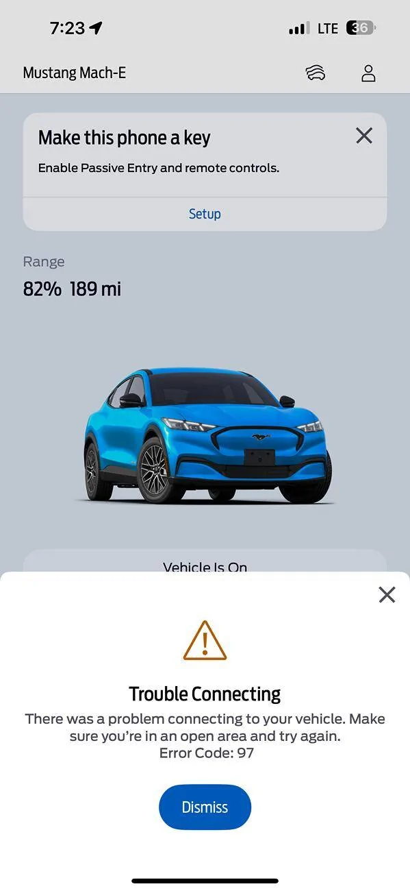

I’ve tried several times to set up PAAK on my phone. And it never works ? always has an error message

Might want to list the steps you followed and post a picture of the error message.

Ok I tried turning off the car play, still got the error message. Posted a screen shot.

Pretty sure that means the car isn't getting a good cellular signal. Make sure the car is parked outside in an area with AT&T cellular coverage and try again. Cellular communication with the vehicle is required to set up PAAK.
If that doesn't work, I'd try a 12V reset next. And finally a master reset from the car after deleting the app on your phone if it still doesn't work.

I had this exact message about 20 times this Friday,
The next day i tried again from a location with better cell service and it worked perfectly. I suggest trying a better cell signal as a way to resolve this.
