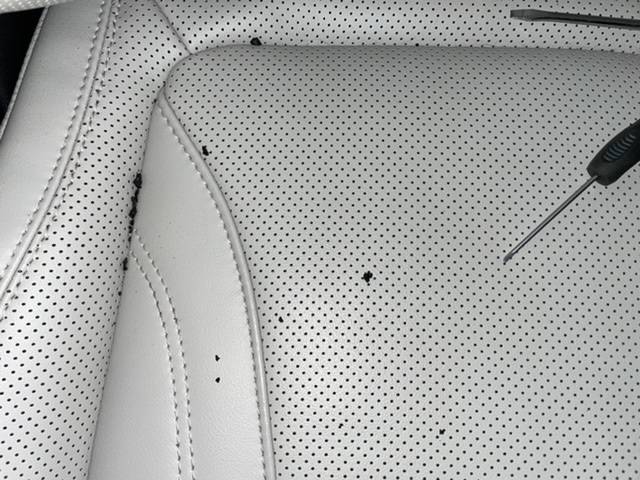

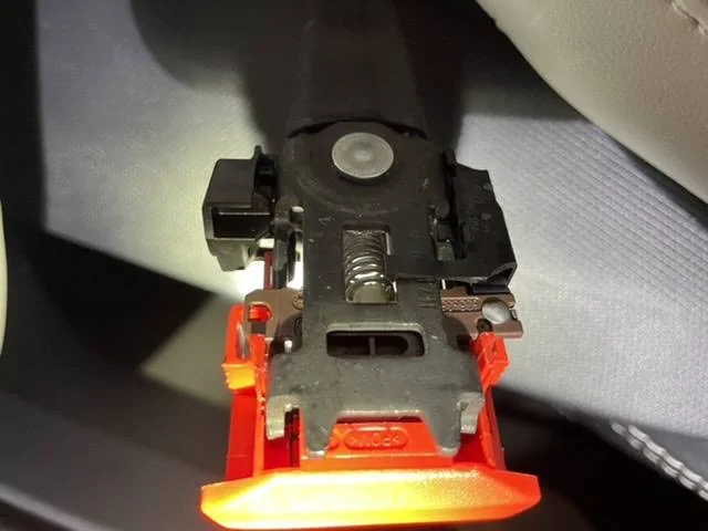

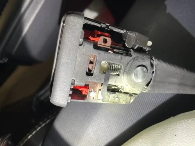

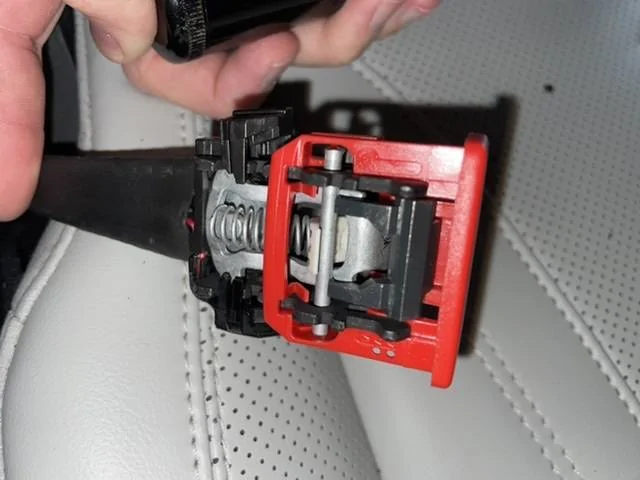

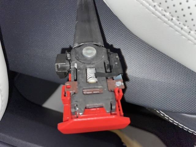

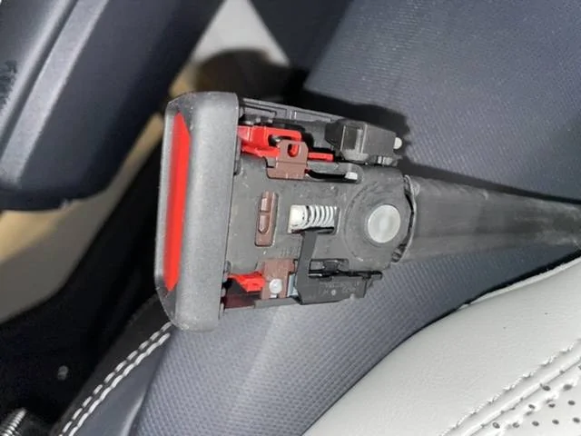

I pried the cover of the seat belt off using a child’s knife across the back of the buckle unit. Once I got that off, it was pretty easy to find the clump of debris that had gotten down into the latching mechanism preventing the seat belt from fulling seating in the buckle. I broke a small plastic piece that held the two sides of the plastic cover together, but it is not at all noticeable and does not impact the belt and buckle function. Hope this helps if it happens to anyone else.
