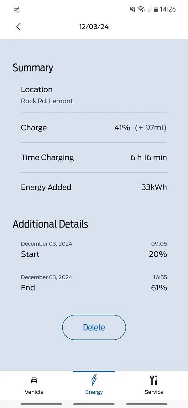

I was charging my 2023 Premium on a Level 2 charger yesterday. It started from 9:05 (20%), and at 12:30 I saw it was around 50% from FordPass. But when I unpluged it at 16:55 it was only topped up to 61%. I checked the Charge History in the app,. and it said the Time Charging is 6h 16min, while the total plug-in time should be 7h 50m. So looks like it charged more than 30% for the first 4 hours but only 11% for another 4 hours? I always use this charger so I assume the charger itself is fine, and the charging target was set to 90%. The outdoor temperature was 23-25F. Anyone has ideas why it charged so few in the second half? And is there a way to check the detailed charging history? Thanks!

Sounds like a charger issue. That IS the detailed charging history...
