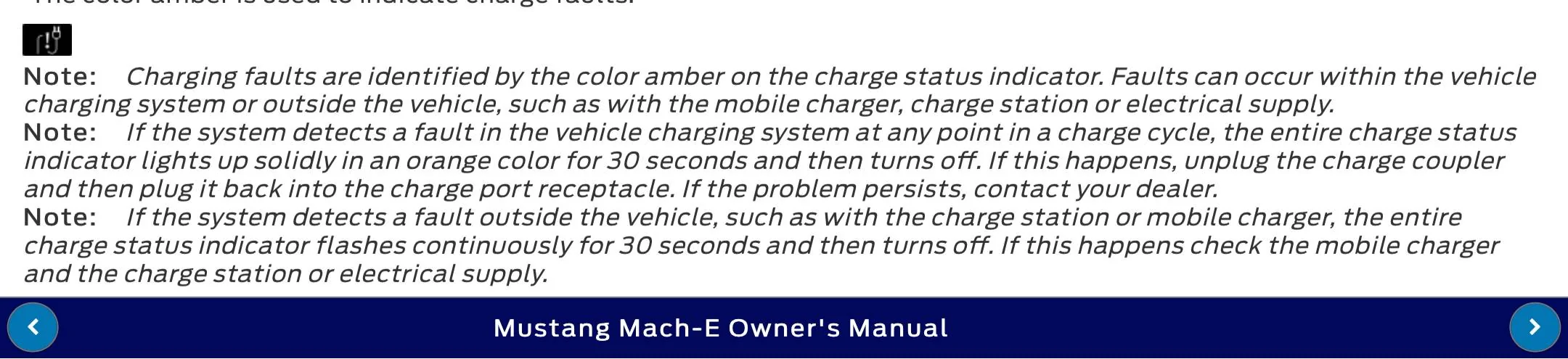

Did the amber flash correspond to either of these notes? If so, it would distinguish between internal vs external fault.
No, it only the LEDs only flashed once for about 1 second.
