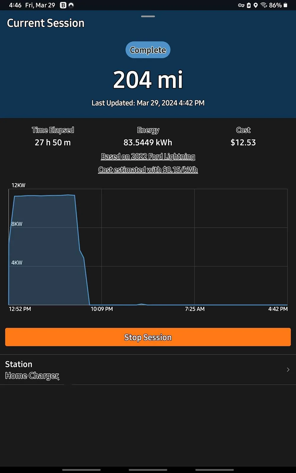

Any L2 charge rate is good! I use a ChargePoint, hard wired on a 60amp breaker (60amps X .8 =48 charging amps). My Lightning came with a charger that can deliver 60 charging amps, I didn't think putting in a new circuit for that was worth it. Here's a sample graph from my charge the other day for my f150 Lightning (the Mach e draws a little less amperage).
Ford Mustang Mach-E Charging Amp Setting in L2 Screenshot_20240329_164622_ChargePoint
