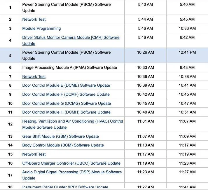

On the 5th they ran a ton of updates

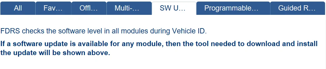

It looks like they have gotten everything updated so far (or FDRS is being stupid and not showing an applicable update)
Ford Mustang Mach-E Lane centering gone after recall work Screenshot 2022-04-08 090525

So there is nothing obvious that they missed. Is that what you’re suggesting?

Not that I can see, no. It does look like they are trying to diagnose the issue currently, though.
However, I am still learning the intricacies of FDRS and OASIS so I very well could have missed something
