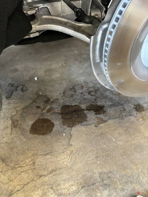

Location of leak on the floor. Definitely a grease/oil of some sort, not AC condensor runoff.

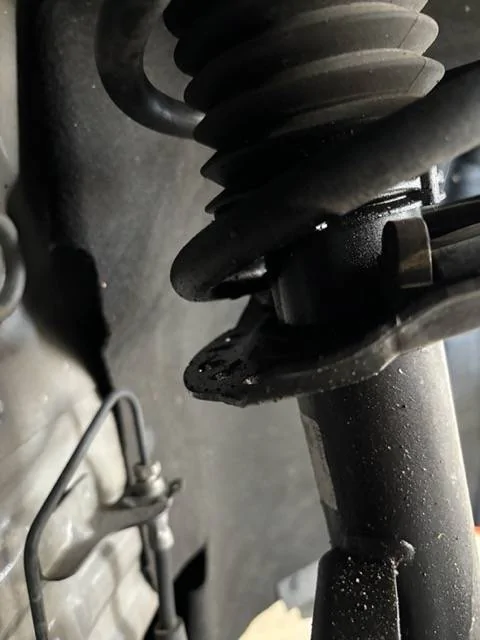

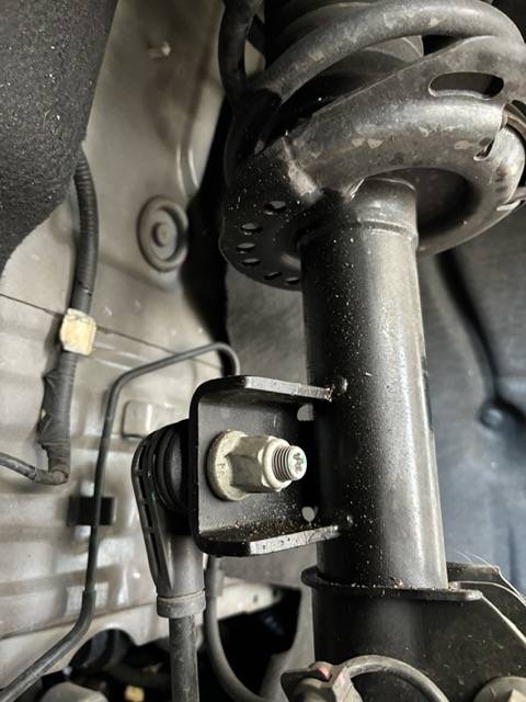

Seems to be originating just above the bottom of the spring. Fluid present on last coil and running down backside of the (shock? strut?)

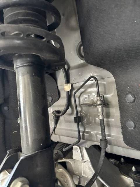

I don't see any leaking around the brake lines.

I believe the shocks definitely contain some sort of oil like fluid. Those are sealed during manufacture so probably a flaw in that one. Should most definitely be covered under warranty.

Yeah I would have the dealer look at that for warranty replacement, agree it looks like a leaking shock. I assume you haven't been driving through any oily substances and the other wheels look normal.
