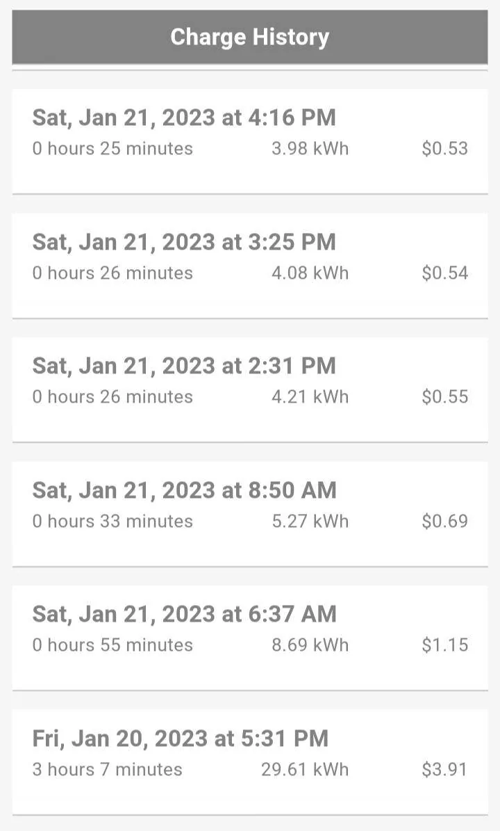

Thank for sharing this. My wife's 21 has developed the same issue.
Ford Mustang Mach-E Level-2 charge fault Screenshot_20230122-110509-168
The bottom session is my 22 from 50%. The rest is her 21.
FordPass is junk. I can go into my Emporia app and restart her 21 without replugging through the car an not the charger, not so with FordPass.
Looks like hers will be heading to the shop.
