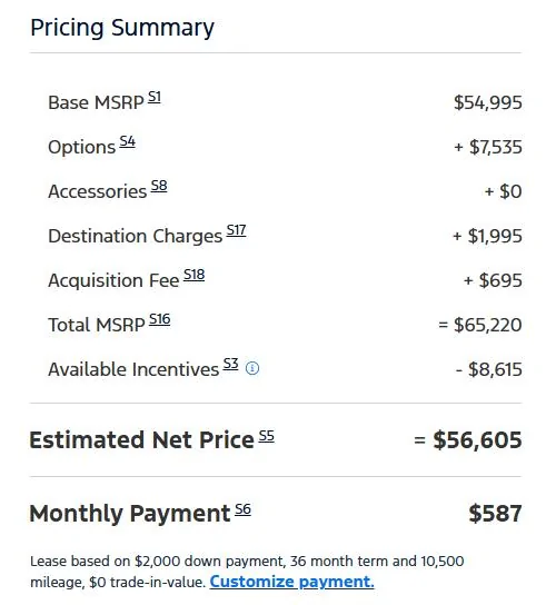

that's a solid deal.
yeah, it sounds like, unfortunately, you got your car during a pricing peak...

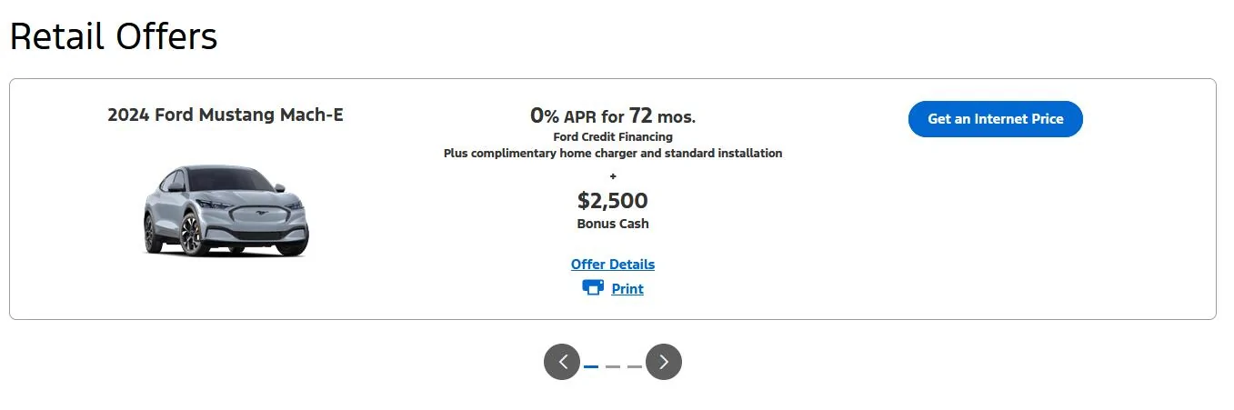

EVs are heavily discounted right now, before the federal rebates potentially go away...
Can't complain. I started the deal with 7.5k of tax credit and 8k for buying out my previous lease and immediately selling it to carvana during the covid craziness. So I only started paying the $943 after 17 months. I have had the car for 28 months. Meaning, I only paid $11K to drive it so far.
There is always a deal to be made. That's the "positive" of dealers, if you can stomach it.

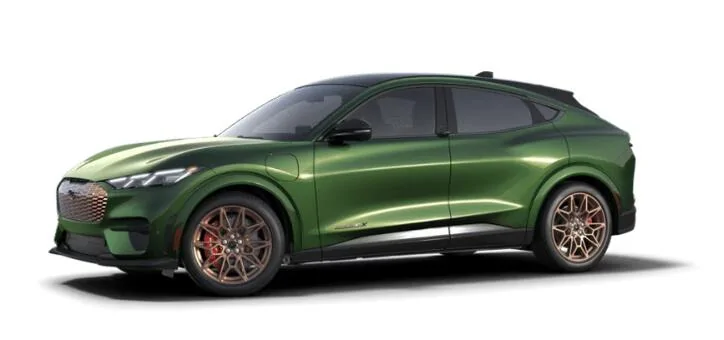

Dealers have done this with other cars in the shop, but those were under warranty. I hope your dealer can approve a trade-in for you on a new GT. Were it me, I would ditch the bronze, glass roof, and BC (but that’s just me). ??
