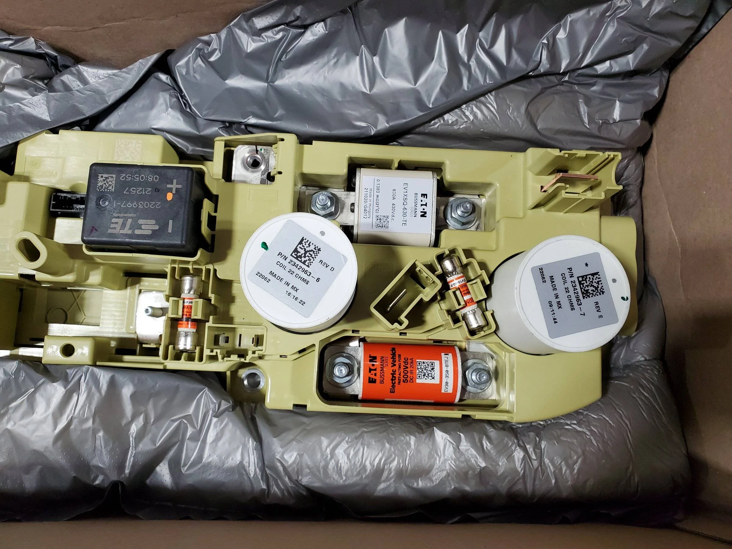

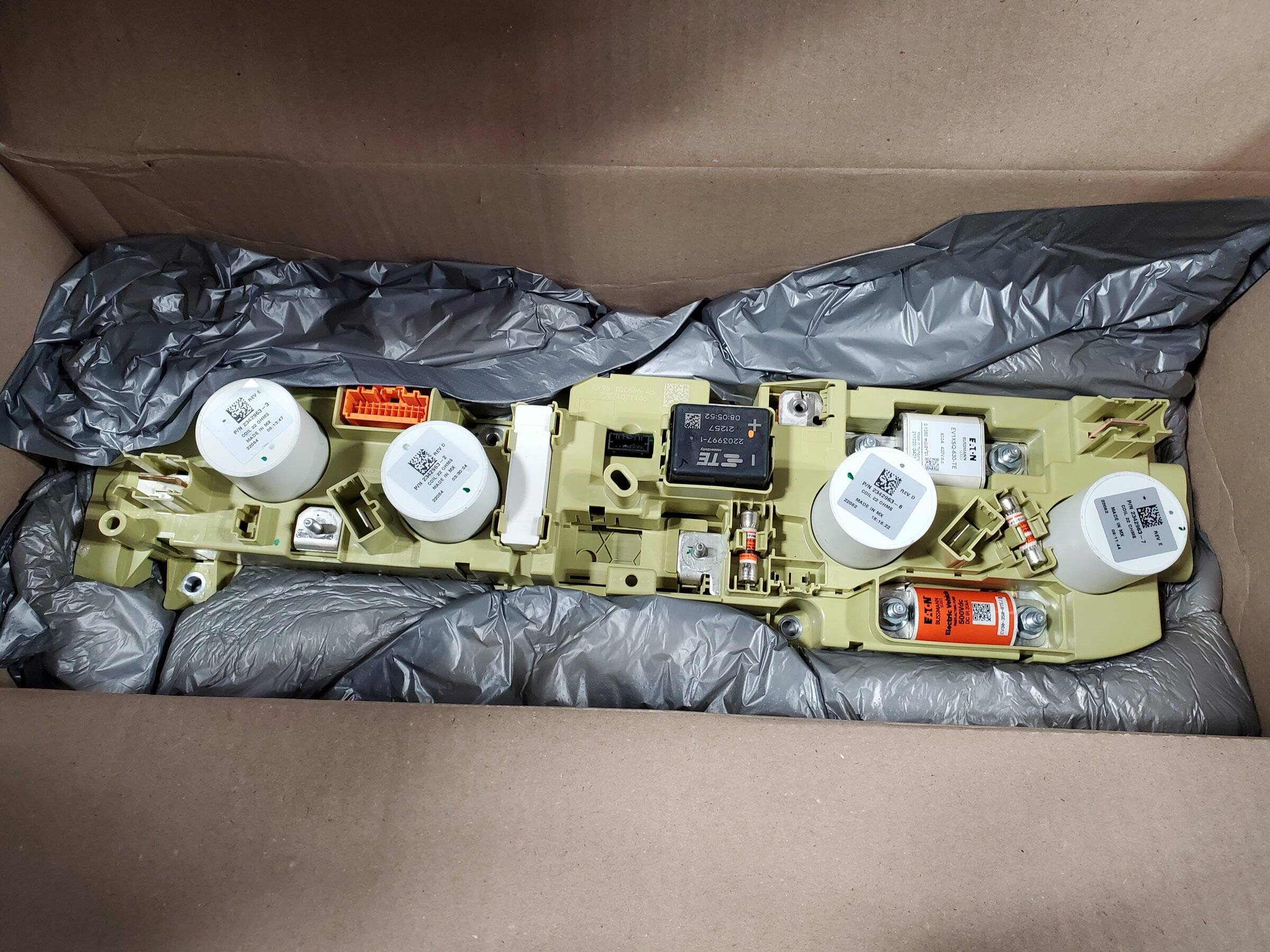

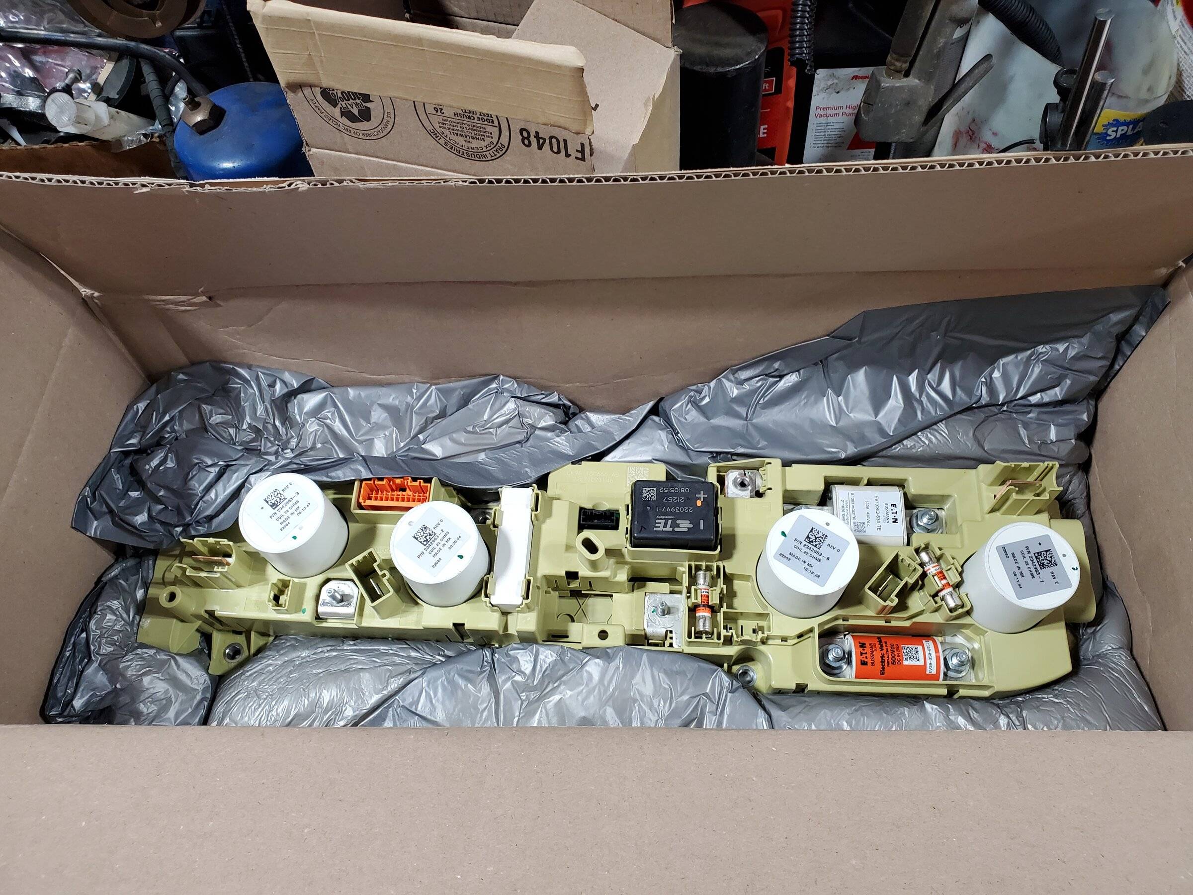

Here a few pics of the new HVBJB. Today 4/11/22 a tech was preparing to drop the battery. Tomorrow crack the HV case and swap the box. I'd imagine it will be done by end of day Wednesday.
That's cool they sent pics! Mine did not take long once they dropped the battery, I bet you're back in the cockpit tomorrow....
