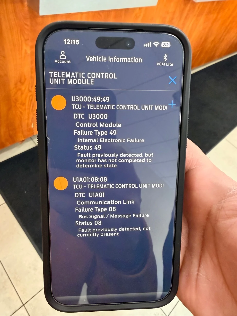

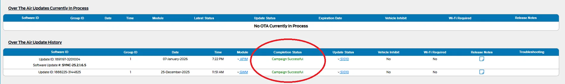

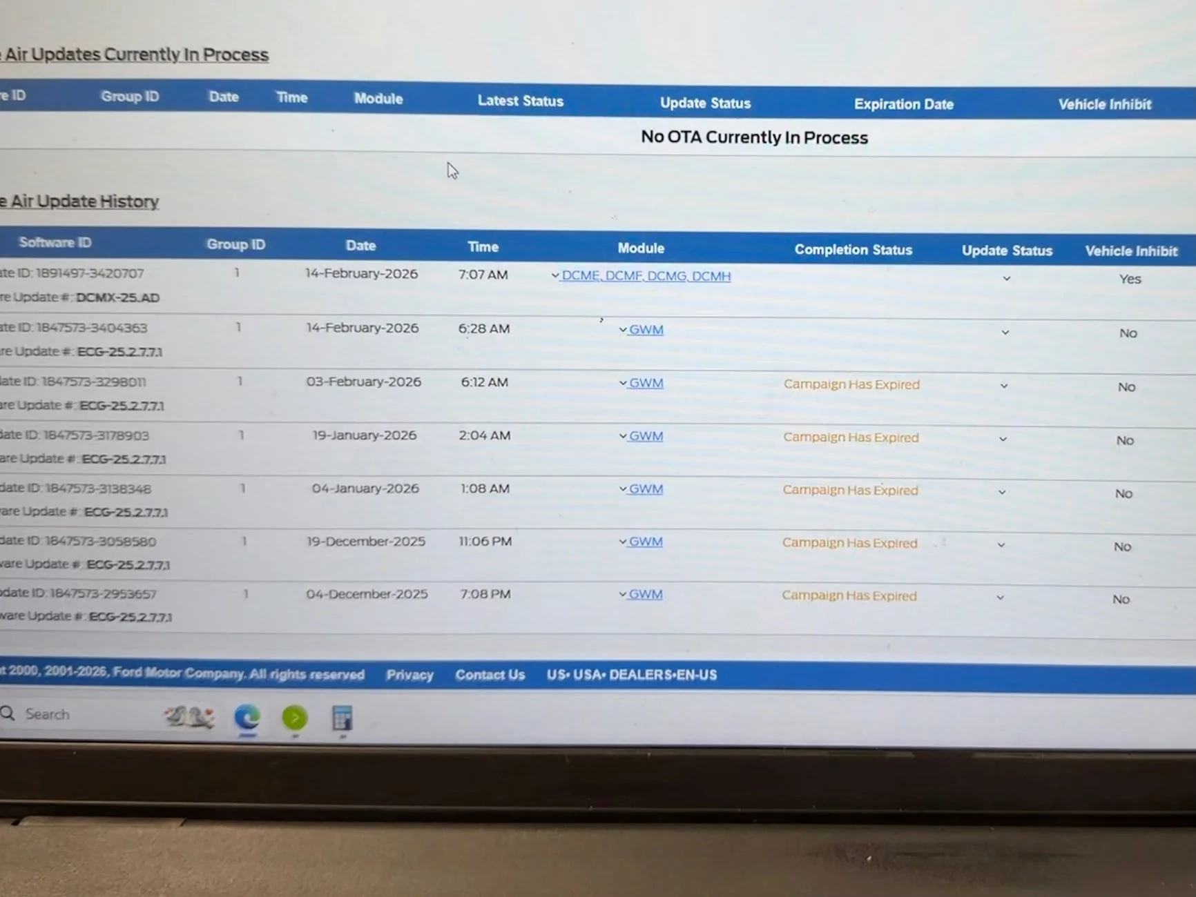

I am not sure. It is possible that those apps are not showing due to the lack of connectivity. I know that if you don't have an active Bluecruise subscription, then the options for lane change assist etc do not appear in the cruise control settings, so maybe this is similar.Oh crikey. I definitely used to have YouTube and Karaoke. It’s a 2025, so it came with them.
without those, what’s the best way to show them that connectivity still isn’t working?
I really appreciate your help!!
It should not be difficult for them to see connectivity is not working; or at least not working correctly. All they have to do is run the VIN through the PTS website and they will see they cannot access any connected data. Unless, you have data sharing to Ford completely turned off, I should be able to see something.
