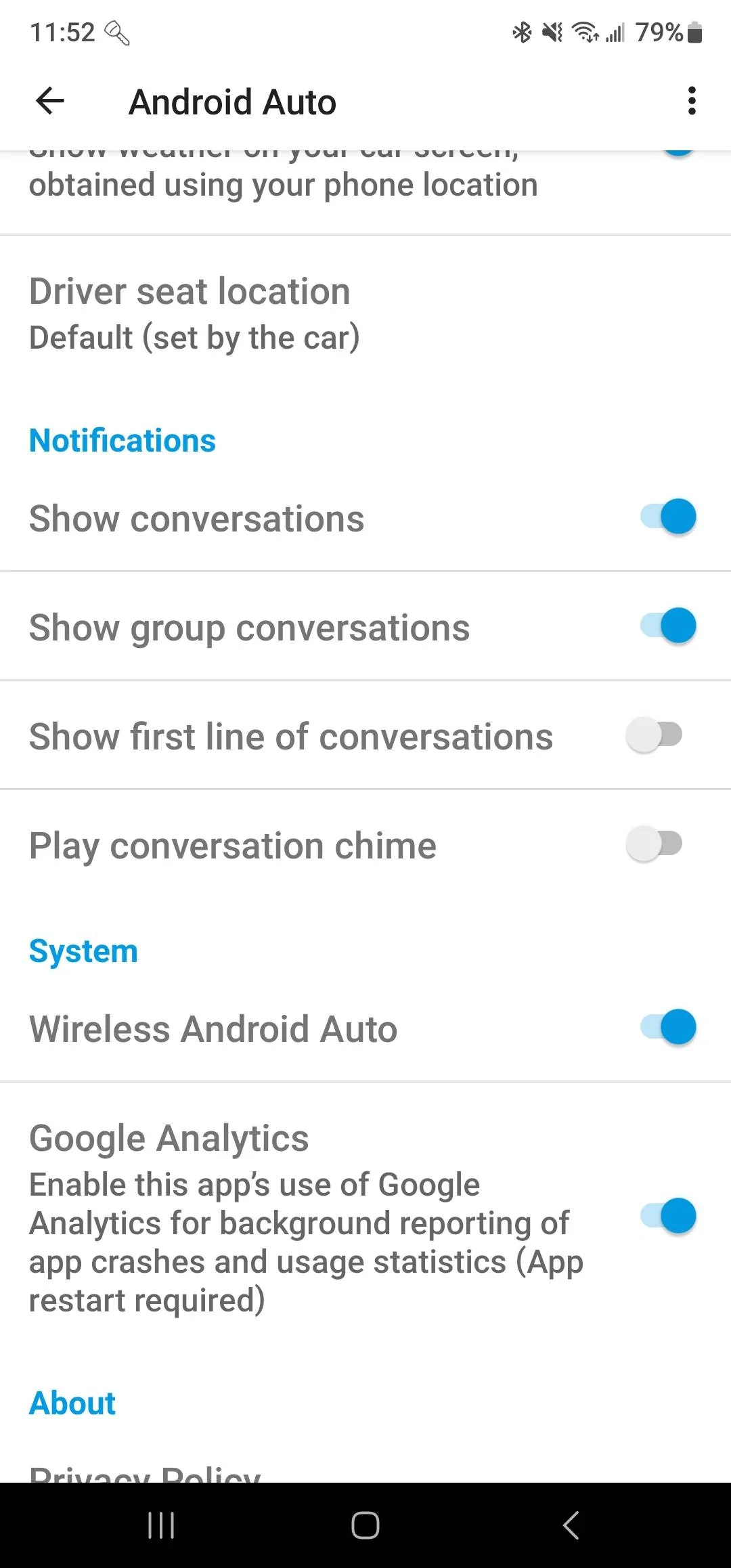

You can turn off notifications in AA settings.
Ford Mustang Mach-E Message notifications Screenshot_20221221_115220_Android Auto

Thanks Mike...playing around with my phone I also found this in the Android Auto app on my phone. Have not yet had a chance to verify that fixes the issue but it seems like it should. I will post again when I confirm. Thanks.
In the Android Auto app on my phone, I turned "Play conversation chime" off but that still did not work...adjusting the volume did but there is a trick to it
