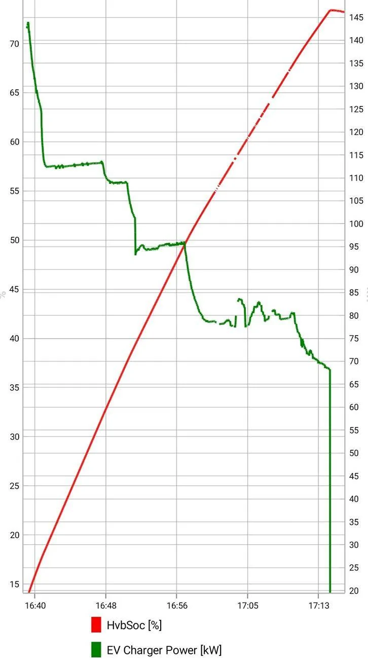

It is very unlikely the charging speed was limited by the charger. It was likely limited by your MME.
That is slower than I have seen at 64%, but it isn't that much slower. I suspect your battery was cold and that reduced the charge speed. See the graph below of my last EA charge. At 65%, I was getting around 80 kW. As the SoC exceeded 70%, the charging speed started dropping below 70 kW. I stopped charging shortly after that, but you can see it is pretty slow in that SoC range anyway.
If you put the DCFC station in the Ford Nav, and you are about 15-20 minutes away from the DCFC stop, the MME will warm (precondition) the battery so it will charge faster. I suspect you didn't do that this time. On a trip, definitely use the Ford Nav for that reason. It makes the DCFC experience better for sure.
Ford Mustang Mach-E Mini rant on DC charging. 1749386120670-rr
