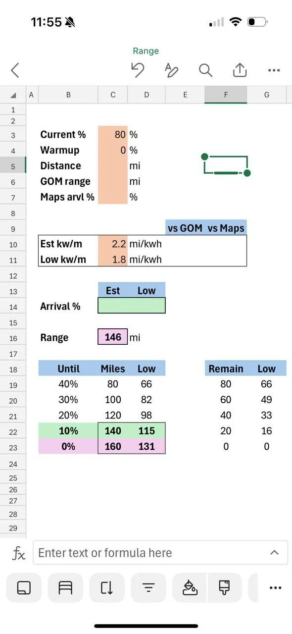

I have 22 ER MME, in NY, and it's my first winter with EV, so, of course, with colder weather and winter tires, range estimates started to be much more tricky.
After taking several trips with temps 15-30F I've realized that Ford's Guess-o-meter or Apple maps constantly overstate the range.
ABPR supposedly should be better, but for me, the free version was still way off in its range estimates, maybe the paid version is better, not sure.
GOM was especially bad: once with 14F temp, I had to find a random charger because I realized that I would not make it, while the initial range estimate was giving me plenty of slack, and then dropped like 30% or so while I was driving.
After that I made a small calculator that I run on my phone in the Excel app to see what would be the realistic/worst-case range, and so far, it works quite nicely for my needs, so I wanted to share, maybe it will help someone too.

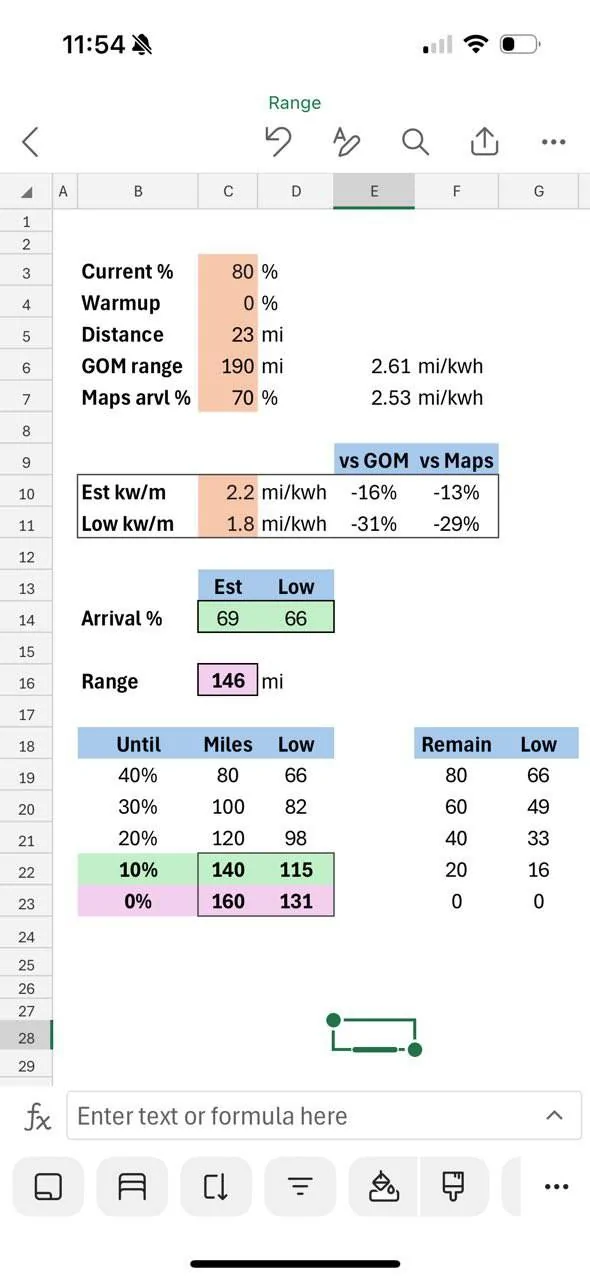

So, basically, I use my own mi/kwh estimate and also show the worst-case range estimate, using 1.8 mi/kwh as a lower end.
So far, I found that for 30F temps, I tend to have around 2.2 mi/kwh, while GOM and Apple maps typically use around 2.4-2.5 mi/kwh as an initial estimate.
The worst case that I experienced was real-world ~2.0 mi/kwh with 15F temps, while GOM was using something much more optimistic.
You can also add distance in the calculator to see the arrival battery % and GOM/maps estimates - to see what mi/kWh they use (approximately). Also, I've added warmup loss that, with the cold car, could be up to 5%, in my experience.
If you use this excel, don't forget to change your battery capacity from 91 to what you need in the top right corner; it will not be visible on the phone screen initially.

FYI the battery capacity will be less than 91 kWh. You lose some due to degradation, and you also lose some capacity when the battery is cold. For example, you might have 5% degradation and 20% capacity loss at 0°C:
91 x 0.95 x 0.8 =69 kWh usable x 1.8 mi/kWh = 124 miles
I also agree ABRP is pretty good at estimating range if you put in all the weather parameters accurately.

In terms of battery degradation - yes, true, but since I don't know what degradation/loss to use I decided that I will just use a lower mi/kwh that I take from experience, but the correct way, I guess, would be to decrease the battery capacity and increase the estimated mi/kWh.

For example, when I put all the movements today in ABPR as if it were morning, it shows that I should be at 44% at the end of the day. My calculator gives me 33%. In reality, it's 32%.
If I calibrate efficiency in ABPR then it should start predicting right, I guess.
