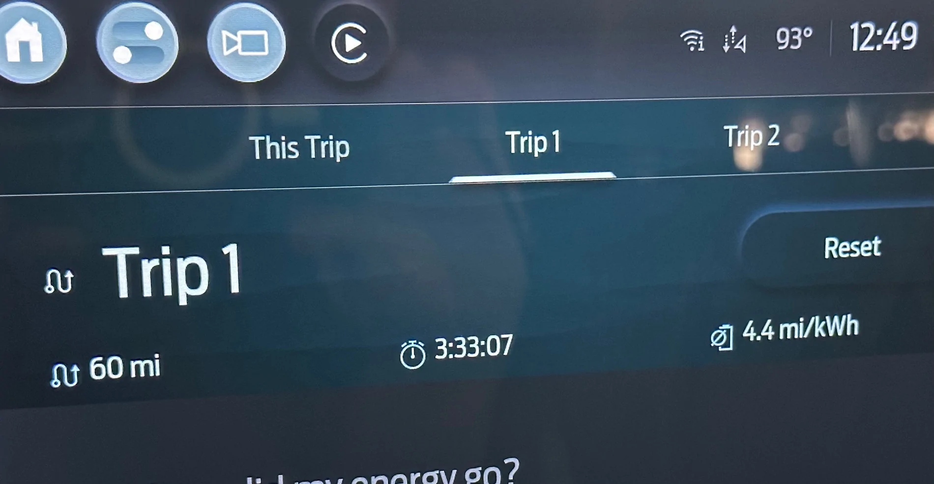

Why does the battery size matter? We’re talking efficiency. For what it’s worth, I have the 75.7 kWh battery. How much of that is usable… 64, 65 kWh? Here’s my efficiency today so far with AC set to 60°F and AUTO level 2. It’s 90°F out right now.
Ford Mustang Mach-E Real World Range IMG_8834

Wow, how many miles was that averaged over?

Read the original thread again.
I don't think the reply had anything to do with the original post. They claimed that 3.5 (miles per kWh) was the max on a 73 kWh battery. That didn't make any sense to me, which is why I asked them why the battery would make a difference on efficiency. Kind of like saying a car with a 12 gallon gas tank will max out at 25 MPG. The tank size (or battery size) has little to do with the efficiency.

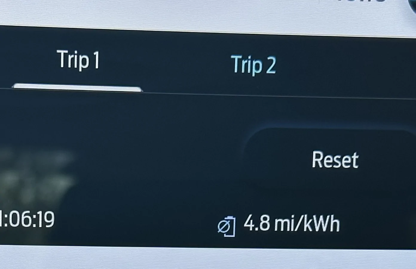

My 3.5 M/kWh assertion was for a 100% down to 0% average efficiency.
I saw 4.8 M/kWh on my GOM today, ain't no way I'm gonna run this Mach-E for 422.miles without charging.
