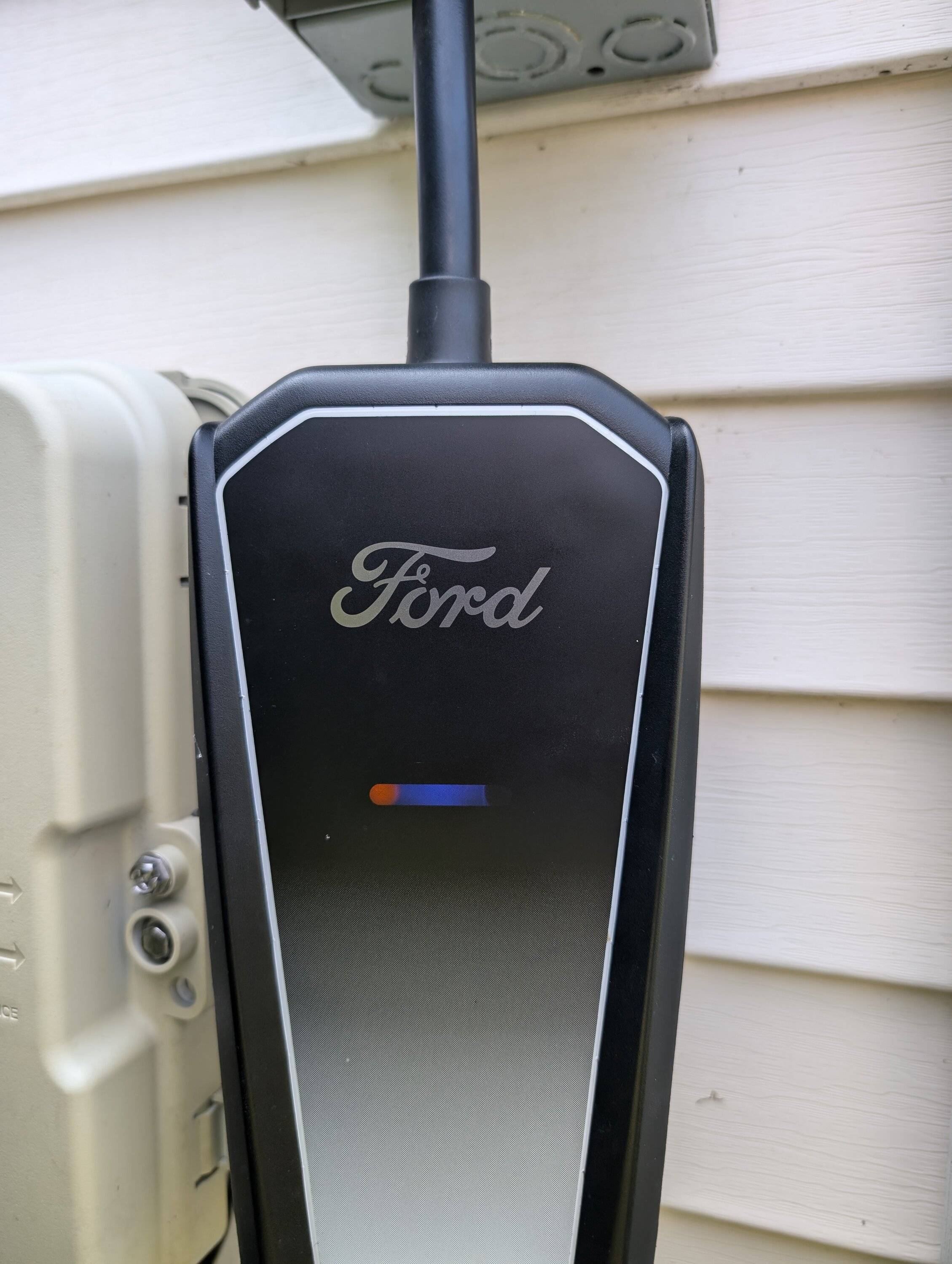

While using my mobile charger recently I've noticed that I more often than not have a small portion of the bar showing as orange while the rest of the bar blinks blue. The charger still provides a charge and appears to work as intended, but when looking in the manual it only talks about full orange or full blinking blue and nothing about a portion of the bar being two separate colors.
Just interested to see if anyone else had this same experience and any thoughts. From doing a quick browse of the forum it seems the most likely suggestion is take it back to the dealer for a warranty replacement (luckily I've only had mine for a year and a half so it should be covered).

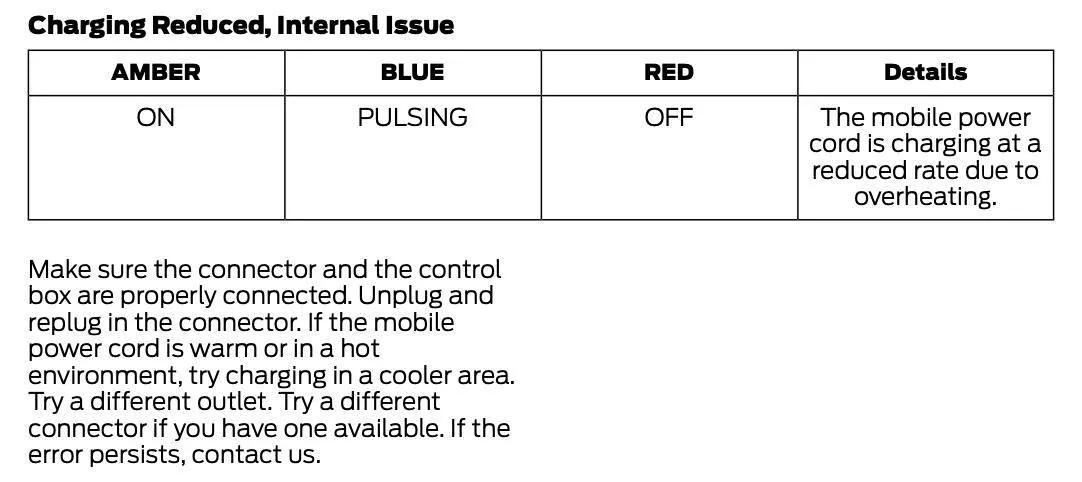

Did you try checking the manual?

Thanks for sharing this. I don't know how I missed this in the manual when I had checked to see what it might have meant.
I suppose the general culprit has been having the unit in my car since I wouldn't necessarily say the outside temp has been crazy hot (80s-90s) and the unit is primarily in the shade all day.
