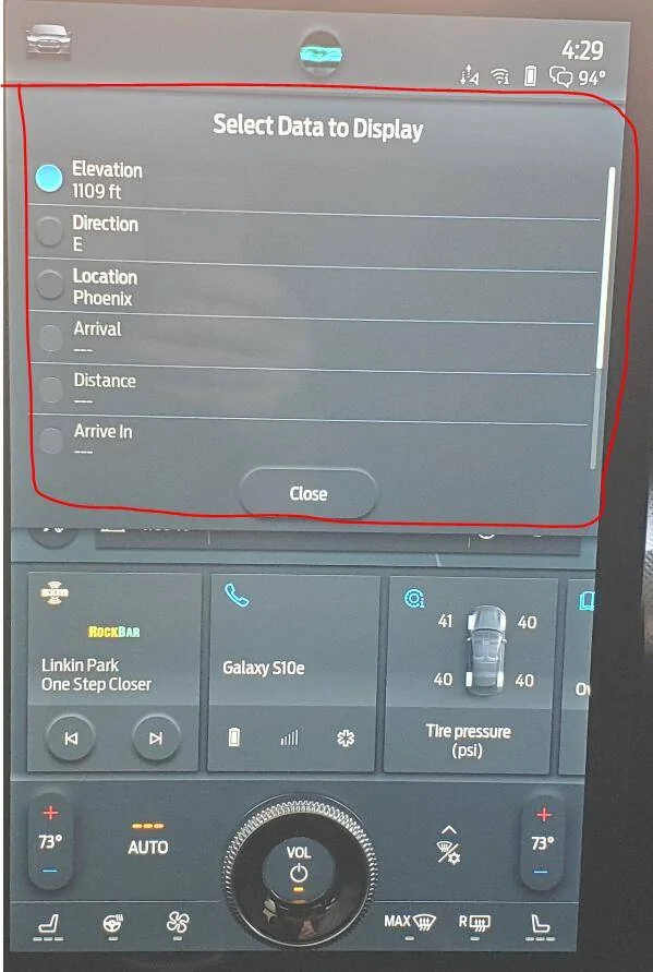

In the navigation you can change to see the time/distance to your next destination by tapping on either values of the bar at the bottom, and selecting “via distance” and “via arrival” and “via in.”
Damn forgot to scroll. Thank you! Does it fix the milage issue in IC?

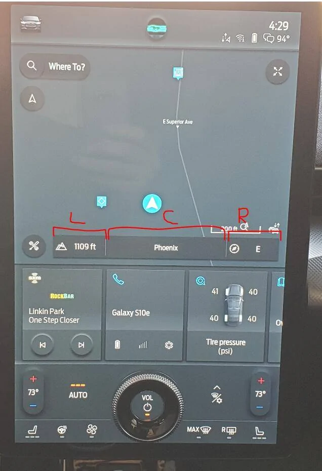

The Left and Right sections bring up the same sub-menu.
Ford Mustang Mach-E multiple stops in nav does not count down milage in IC 1618270512039

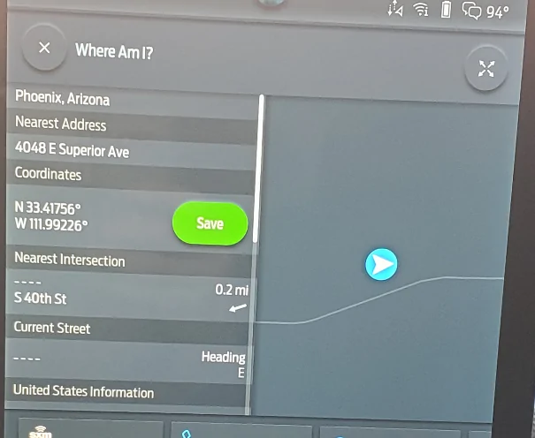

The center area is labeled "Where am I?" and you have to scroll to see more stuff....
Ford Mustang Mach-E multiple stops in nav does not count down milage in IC 1618270669476

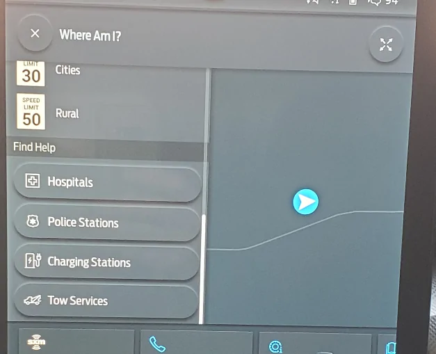

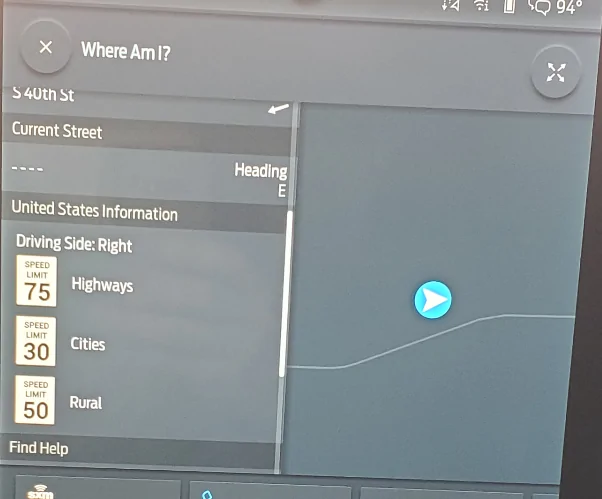

Scroll down....
Ford Mustang Mach-E multiple stops in nav does not count down milage in IC 1618270717829
scroll down a little further to the end....

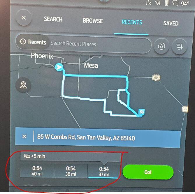

Program a destination and some more stuff is available.
I normally get 3 route choices. These might be Quickest, Shortest and most Economical since that is how my Focus Electric would display the routes but I am not convinced this is what happens in the Mach-E. In this example....the 37 mile route would normally take about 49 minutes but traffic must be heavy right now so plan for an extra 5 minutes to the trip duration. You can look at the other choices to see if the estimation is affected by traffic or construction etc.

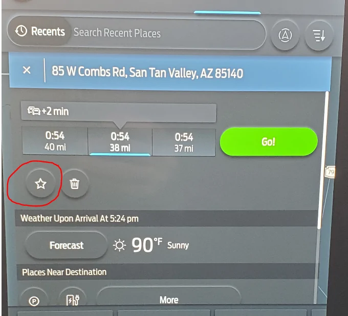

If you pull the blue bar up towards the top of the screen then there is more stuff below this that comes into view.....
The star is where you can save a favorite. Took me forever to find this......

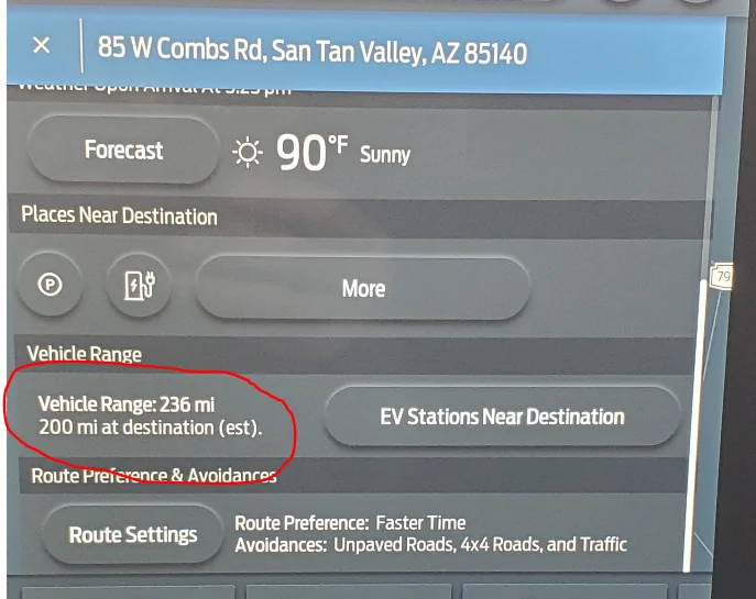

Read down a little further and there is some more useful stuff.
I like the estimated miles of range at the destination. That might be pretty useful someday....
