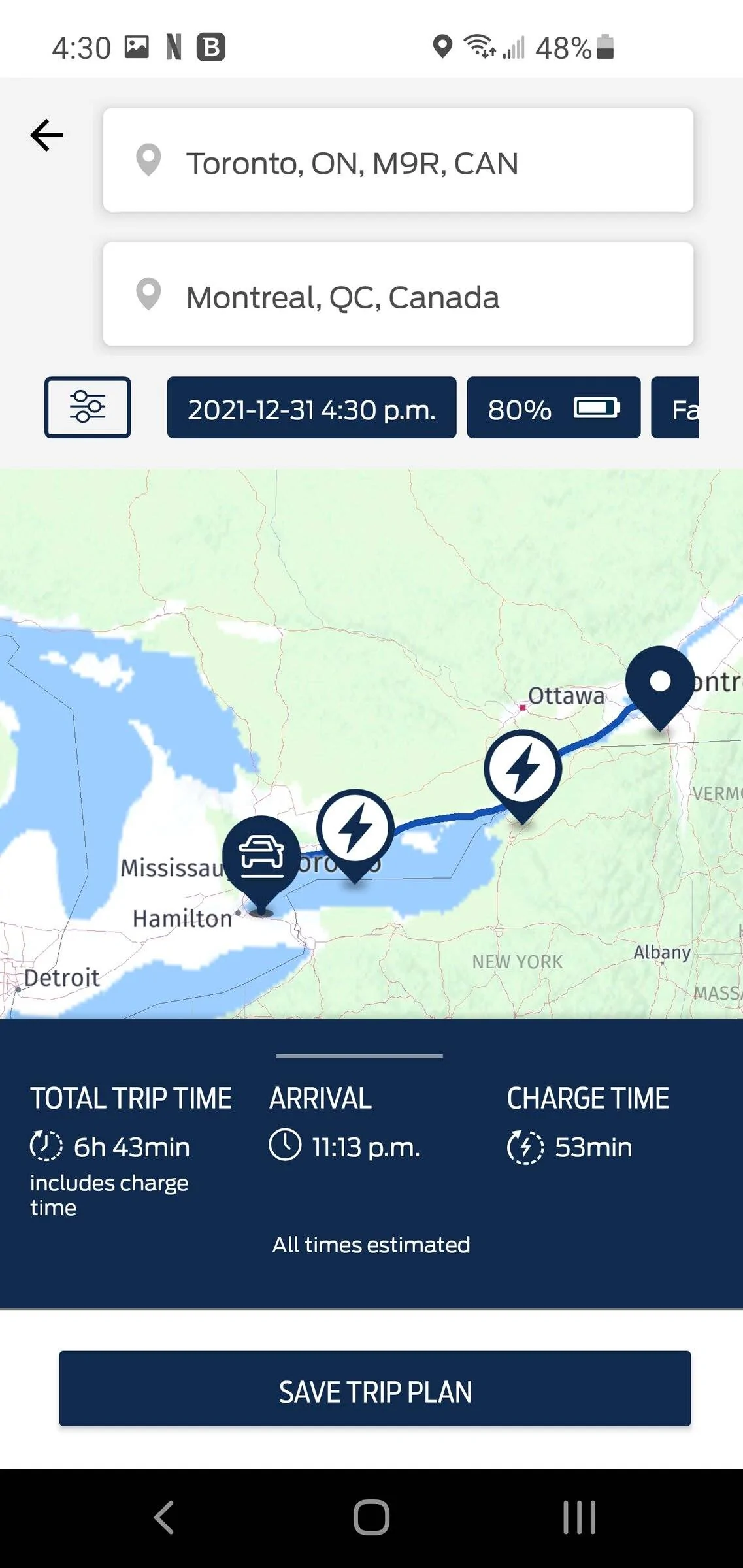

Maybe I'm missing something incredibly silly and obvious, but is there a way to add multiple stops to the trip planner on the Ford Pass app?
Right now as far as I can tell, you can basically supply only two inputs, your start point, and your end point. But what if I was on longer journey and wanted to plan out multiple stops along the way based on estimated energy consumption to plan ideal charging stops based on nearby amenities?
As it stands right now, it's not very useful to me as a "trip planner" when I am limited to basically a single destination.
I do see that if I add a destination outside the range of the vehicle it auto adds pit stops for charging, but I would like to add multiple stops manually and upload to vehicle rather than just having it randomly select stops based on charging alone without concern for nearby amenities etc..
Also, yes I'm fully aware I can use ABRP to do the same. But I would like to know if I can do it on Ford Pass app, because I like the ability to upload the trip to vehicle ahead of time in case Android Auto goes wonky, as it sometimes does.
Ford Mustang Mach-E How to add multiple stops to trip planner? ? Screenshot_20211231-163053_FordPass
Ford Mustang Mach-E How to add multiple stops to trip planner? ? Screenshot_20211231-163043_FordPass

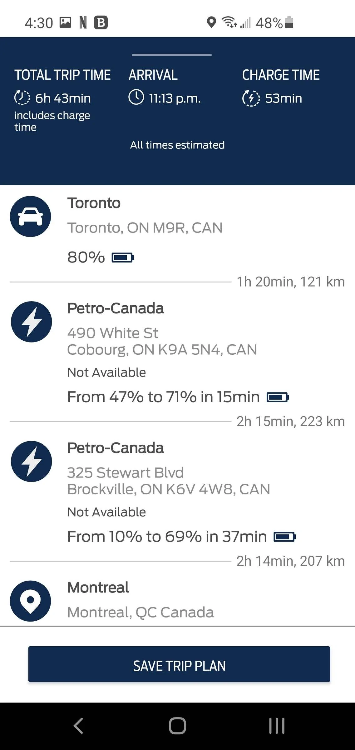

FordPass -> Map -> Trip Planner (aka "Power my Trip") -> Create New Trip Plan
Enter start & destination. It will AUTOMATICALLY add charging stops (If needed) based state of charge when you start the trip and predicted consumption ... and it's actually pretty good at this.
Once it calculates the trip, you'll see a map overview of the route with charge stops. Below the map it will show "Total Trip Time", "Arrival Time" (that's based on the departure date & time which defaults to the current time but you can set it for a future date & time) and the total amount of "Charge Time" on the trip.
If you don't like any of the selected stops, expand the details by tapping the up-arrow (where it showed the trip summary). Pick a charge stop. It'll expand to show details of that stop. Then pick "Change Charge station" and this opens a map (you can zoom out) to show other charging stations that might be nearby.
