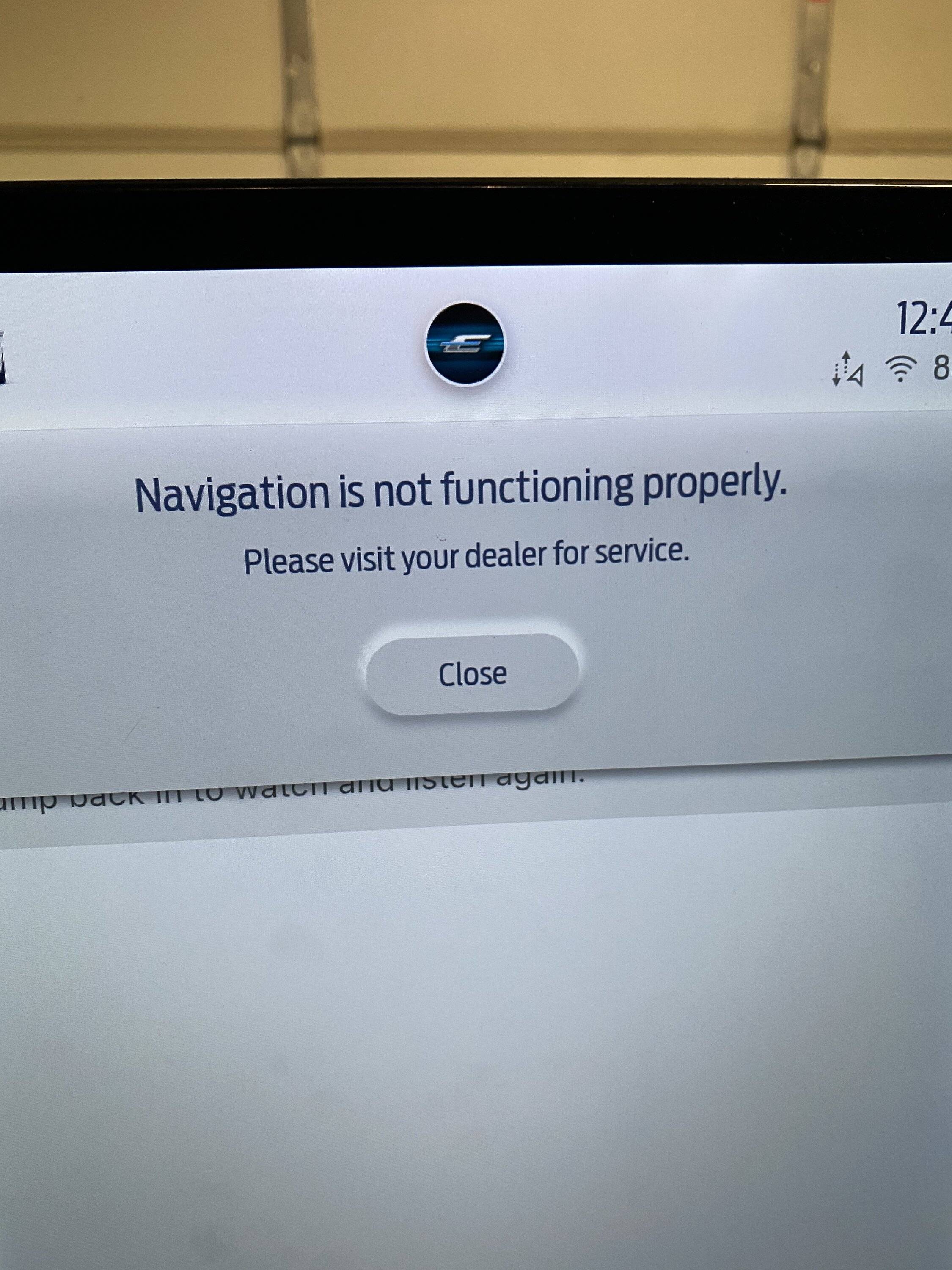

I just received a notification on my screen that stated “ Navigation is not functioning properly “ “ Please visit your dealer for service”
Anyone experience this and what was the fix?
Ford Mustang Mach-E Navigation is not functioning properly 80A6F48F-0BCF-4EBB-B154-28804A655030
11,356
24,981
Interesting, this is new, looks like they added software to detect GPS issues. You might have a problem with an antenna cable or need a new APIM.
The older SYNC software doesn't notice and your car will be drifting through a field or lake on the nav screen.

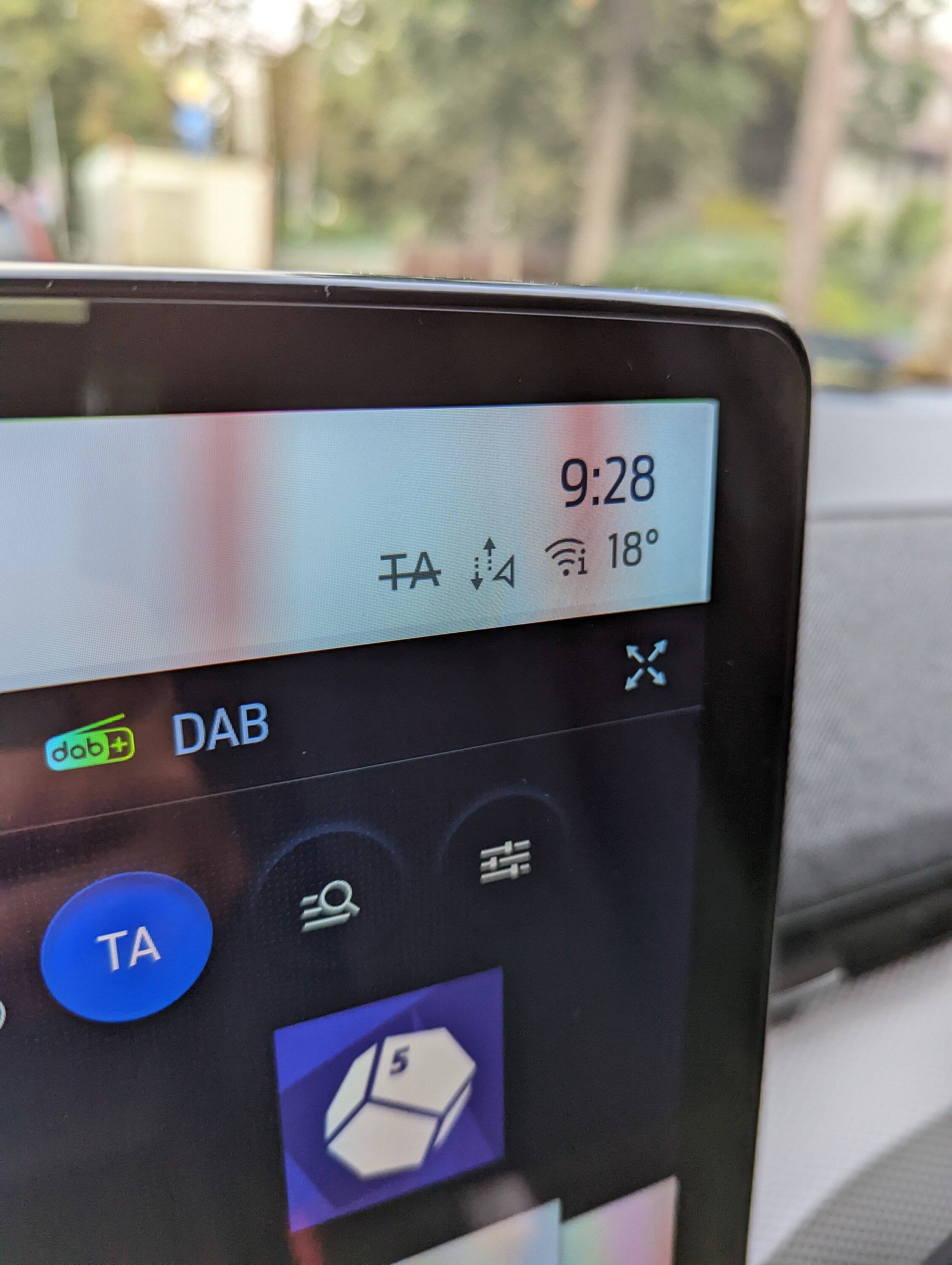

Sorry for using your post, but what does it mean if I have i simbol together with wi-fi icon? Search couldn't help me.
That means there are wi-fi networks available but SYNC is not connected to any of them. When a connection is established i symbol disappears.
