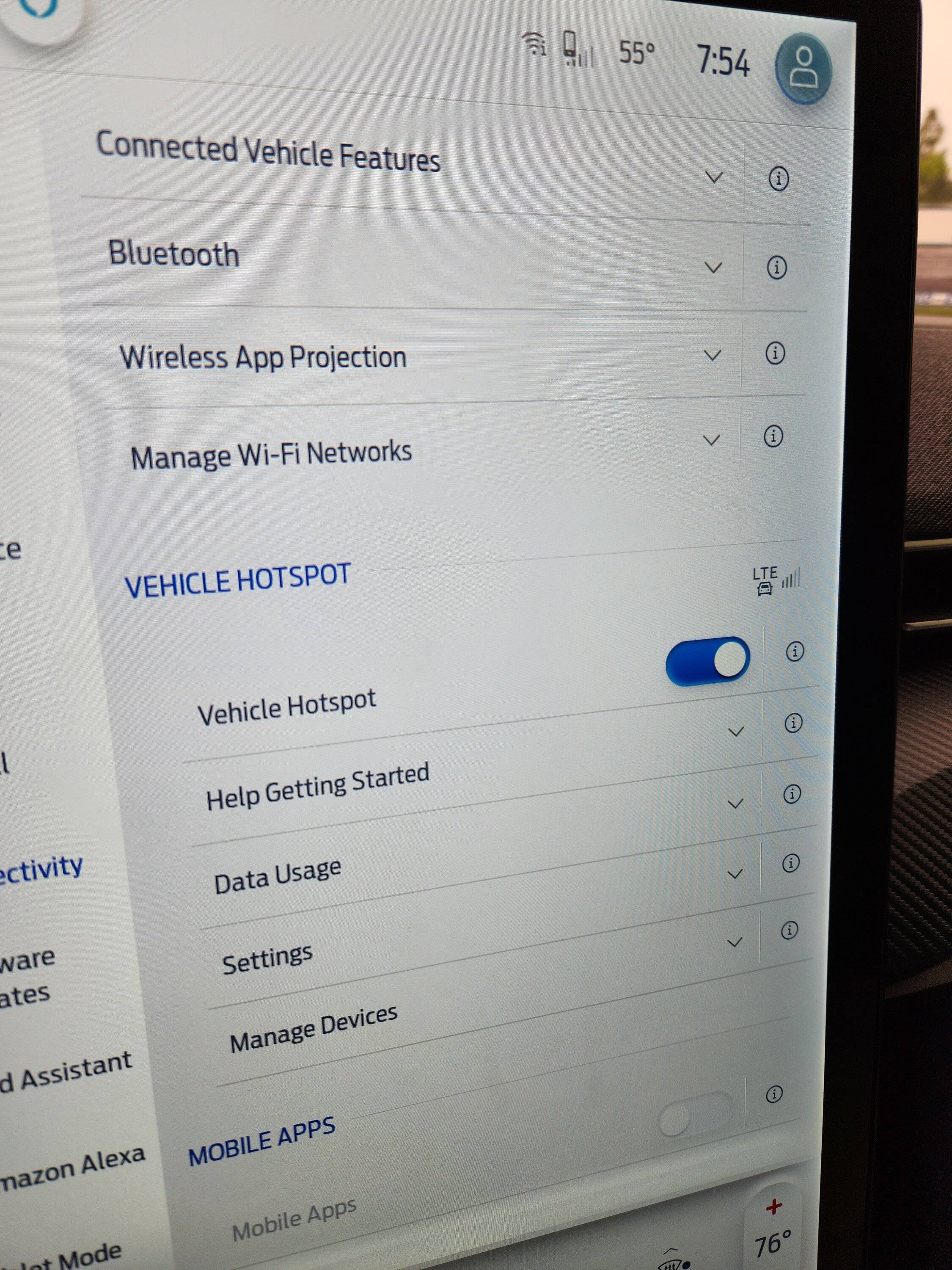

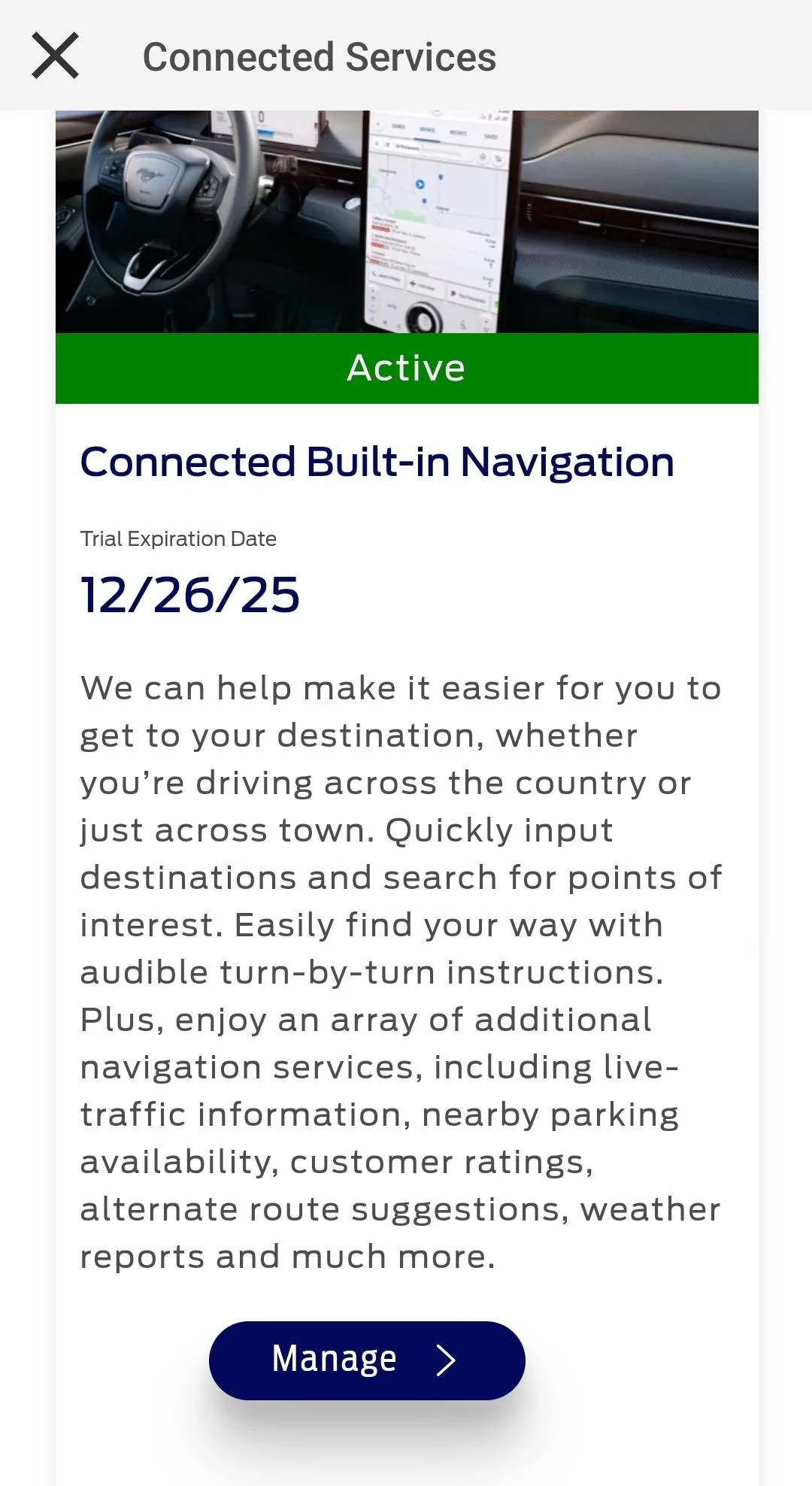

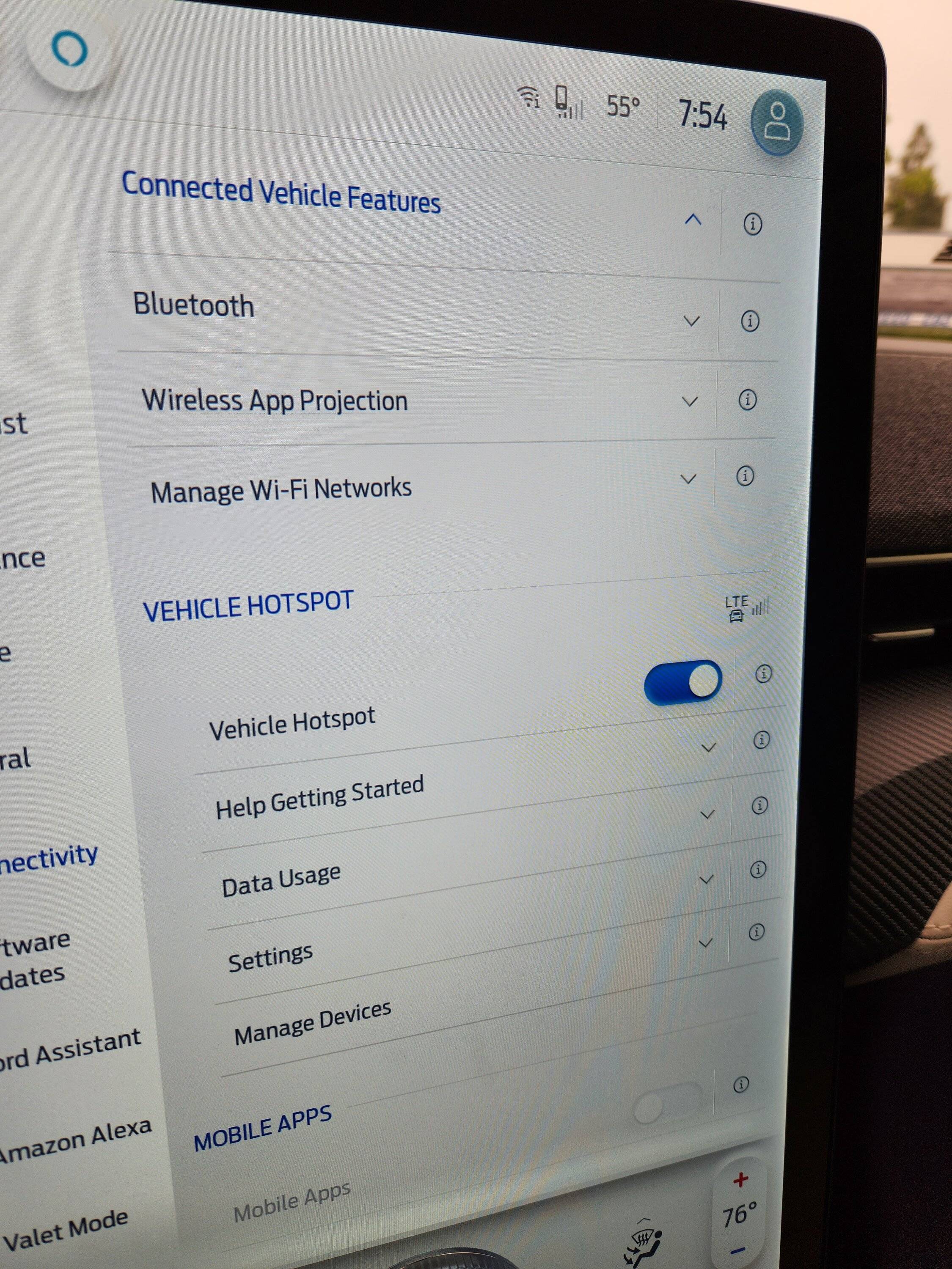

It tells me to activate connected vehicle features but when I go to the menu it is empty.
Ford Mustang Mach-E Navigation not showing traffic 20230315_075435
Ford Mustang Mach-E Navigation not showing traffic 20230315_075429
Ford Mustang Mach-E Navigation not showing traffic Screenshot_20230319_133610_FordPass
