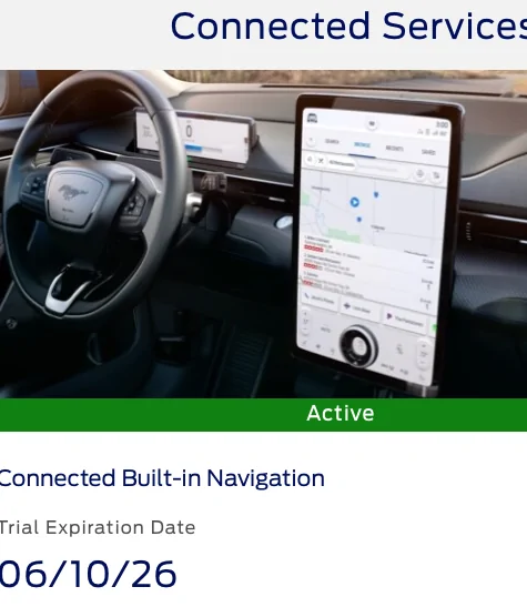

After chatting with Ford online, the OTA rep says that my MME modem is active and online.
They did something on their end and now it shows Connected Built in Navigation with expiration date showing.
I'll try it out today.
Ford Mustang Mach-E Real time traffic Ford navigation not working ?  Something missing or setting I need to change ? Screen Shot 2023-06-19 at 8.34.25 AM
