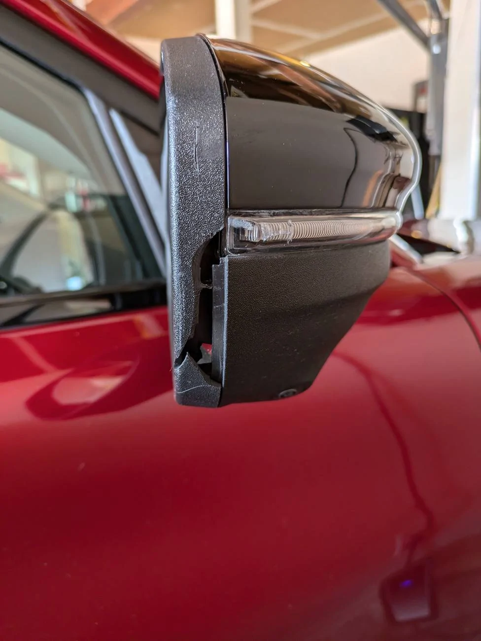

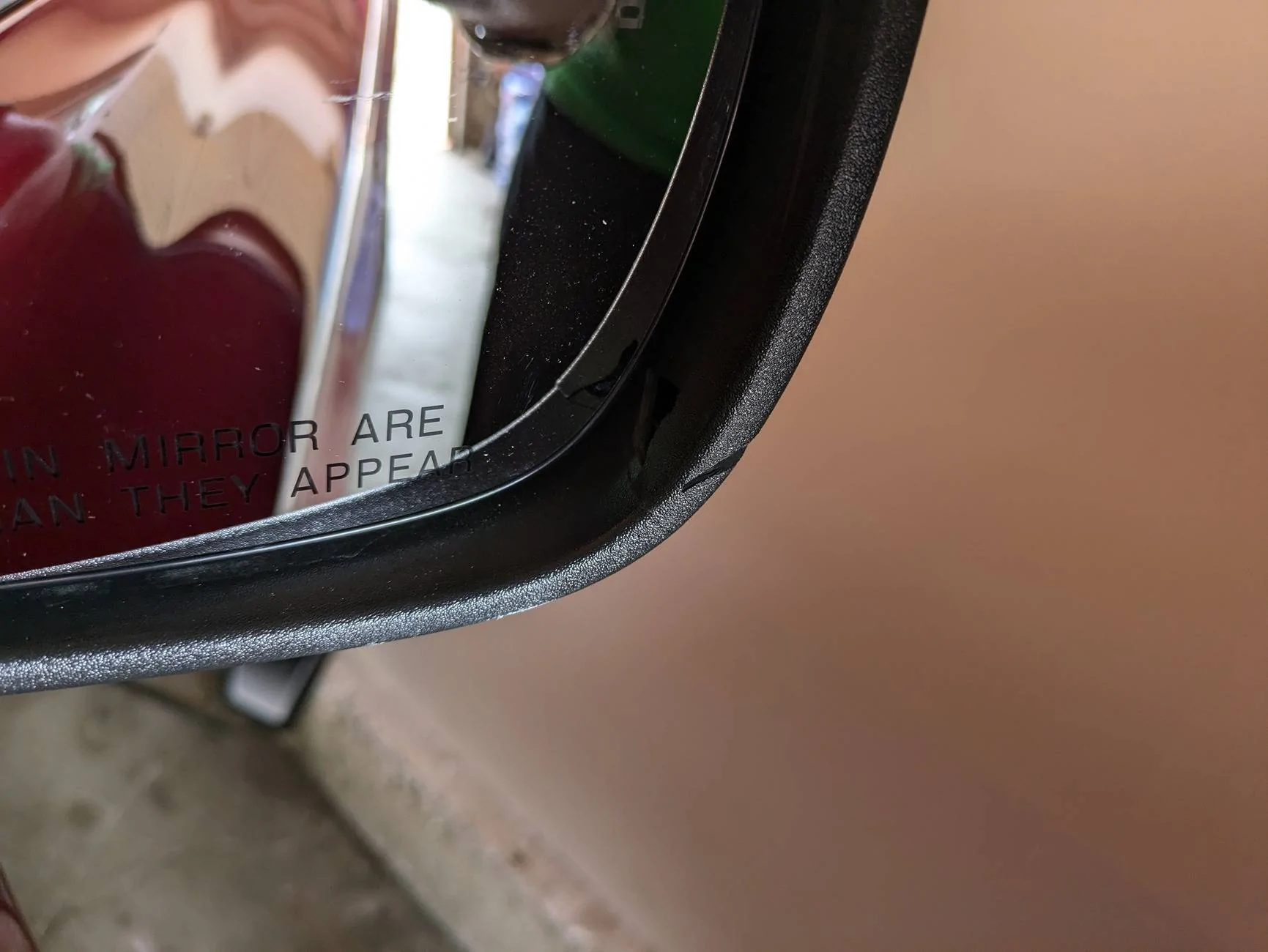

Tale as old as time: I was backing out of my garage and clipped the right side mirror. The front trim is cracked and the top cover popped off. It seems the front cover is not cracked (at least not on the outside). I am able to put it back on. However, the front bezel now has holes (see pics below).
I was able to find the bezel here: https://www.varsityfordparts.com/oe...hY2gtZSZ5PTIwMjMmdD1wcmVtaXVtJmU9ZWxlY3RyaWM=
Could someone please post the steps on how to replace the bezel?

By painful experience don’t remove the coloured backing like he does.
First remove the glass by rotating it outwards, get something flat to pry the centre of the glass off the central mount clips.
Then release the clips for the coloured backing from around the inside where the glass came from - if you do it like his video you’ll run the risk of breaking something.

In fact, looking at the parts view and from memory, you probably won’t even need to remove the coloured backing parts because once the mirror glass is out the way the screws for the bezel are accessible - 5 minute job ?
