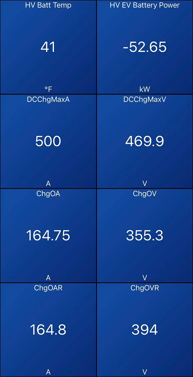

So I made a car scanner page to try and get to the bottom of things. I’m at a Tesla Charger. Started at 72Kw speed with a 38° battery at 42% SOC. I guess my ford navigation ended because I couldn’t set it to a charger for a destination. So no preconditioning today. 72KW feels about right for those conditions.
Looks Like my limit at the EA station Saturday was because of the station, not my car. I feel much better about that.
Ford Mustang Mach-E Need help with CarScanner IMG_2343
My car scanner page shows that while the charger‘s max is 500V and 500 amps, the car is requesting 394V (~400V) and 165 amps or about 65KW. Again, feels about right for the battery temp and SOC. The Charger is delivering the correct amps and a little less Volts. No biggee.
Big thanks to @RickMachE and @kodiakng for helping me figure this out.

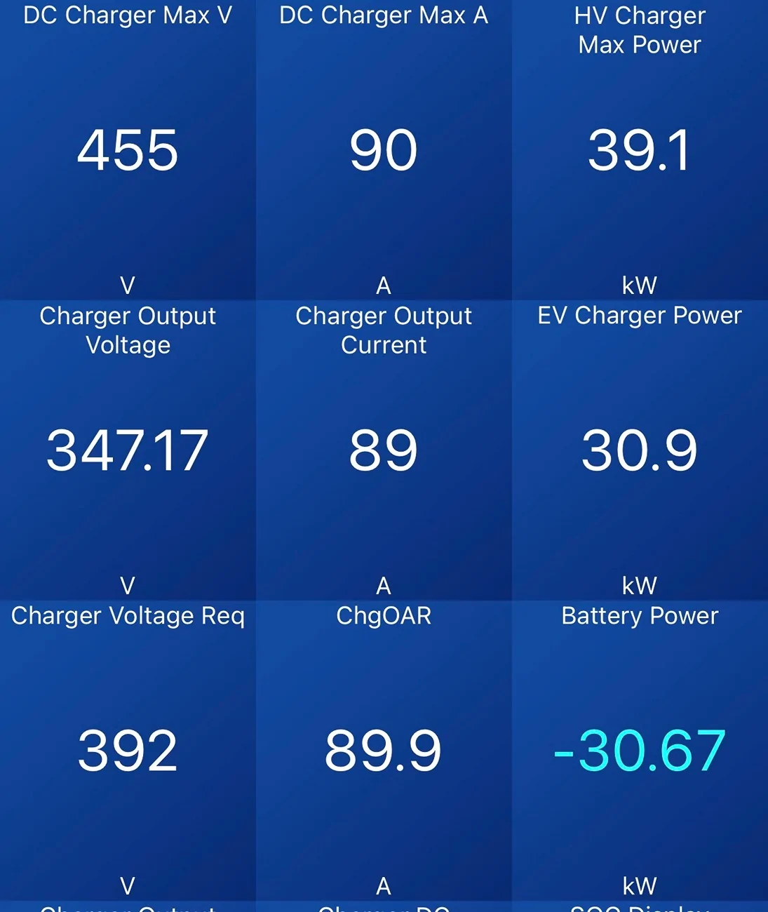

Thanks Rob. I didn't mention, I tried calling EA to reset the charger and they said no because there was no fault showing On their end. My main concern was that I tried 3 chargers with the same result and everyone else that came and went seemed to get higher rates of charge.
if I’m reading this screenshot correctly, the Charger is saying is can do 455V at 90amps for a max raw of 39KW. (top line) and is actually providing 347.17V at 89amps for a rate of 30.9KW (second line). And then the car looks to be requesting 392V at 89.9amps which would only give me 35.2KW but I’m actually getting a rate of 30.67KW (third line).
Can you tell me if I’m reading that correctly?
The 90A is the one to watch. That should read 500 for a 350kW EA charger. If it reads 90, it's a "fail-safe" mode charger. Unplug, try another stall.
Of course, that current limit will be different on other chargers from other manufacturers, and not seeing 500A isn't a failure mode in those cases.
11,365
25,025
Top numbers, charger is only capable of 90A and 39 kW max. So bad charger.
thanks. When EA refused to reset the charger and multiple chargers only gave 30KW, I really thought it was my car.

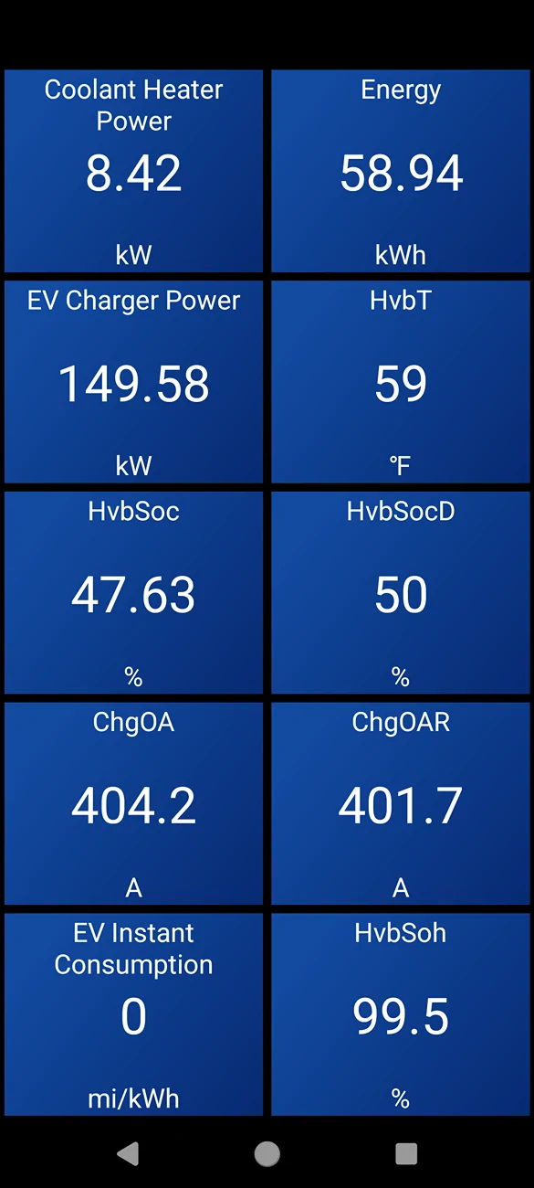

I use two fields:
ChgOA and ChgOAR. OA is the offered from the charger, OAR is requested from the car. I have a screen that I made that has the fields I want all together. This is from the Lightning, but they use the same screen.
Heater power Energy in battery
kW the charger is putting out Battery temp
Actual state of charge Displayed state of charge
Charger offering amps Vehicle requested amps
Instant efficiency State of health
