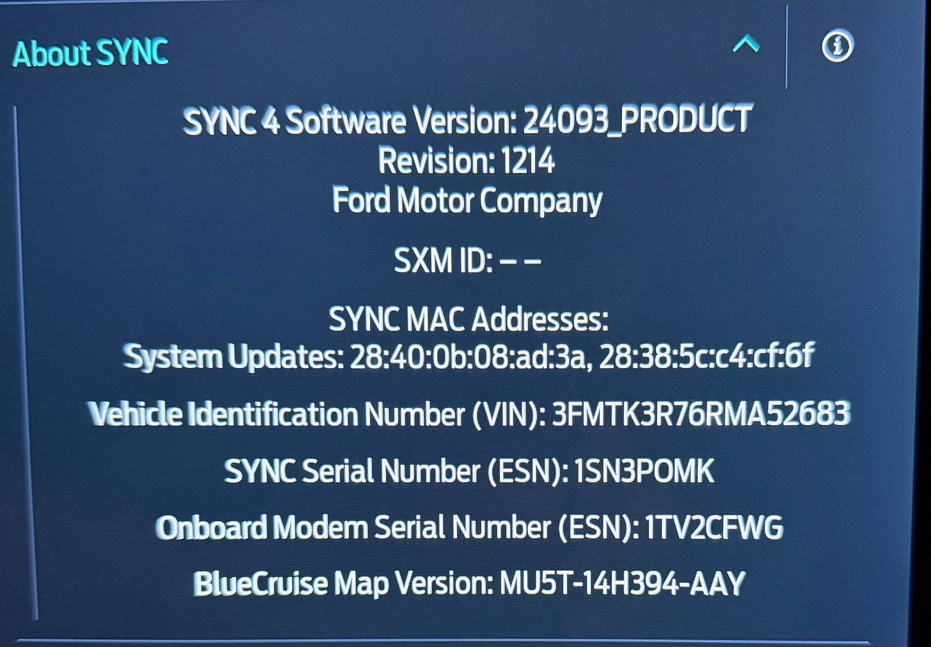

welcome to the forum.
The updates you’re looking for are under the main menu/software updates. Not the Sync version, that doesn’t get updated very often
also look here for all the software update info.

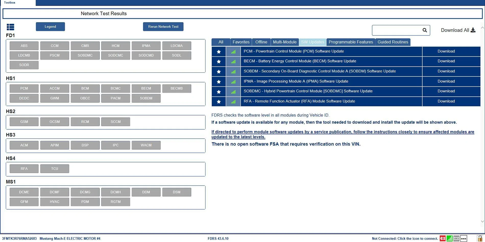

Here's what you have pending via FDRS. Anything that is technically needed would eventually be sent via OTA.
Ford Mustang Mach-E Need to check for updates 3FMTK3R76RMA52683
There is an available TSB, TSB 24-2445, that may be applicable to your car if you have issues with L3 DCFC. https://www.macheforum.com/site/thr...error-msg-displayed-dtc-stored-in-becm.41285/.
Your car was built 12/3/2024 and this TSB applies to Ford 2023-2024 Mustang Mach-E Built on or before 06-Dec-2024. Doing this would knock out 4 out of 6 available updates, leaving the IPMA and RFA. I'm not aware of any current OTAs that would update your model year IPMA and RFA modules since your car is so new, but perhaps others here who have more knowledge on this may be able to chime in.
