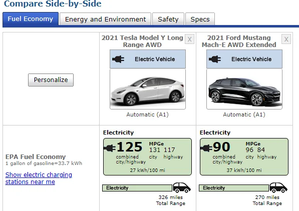

Ah, thank you, I did not know that. So I assume the manufacturer provides drag coefficients and then they just adjust the dyno loads to simulate it?
If this is accurate, then the Mustang Mach-E has about 24% higher drag, which translates to some proportional range decrease compared to the Y. (.23 vs .285).
Still, this doesn't tell the whole story.
The Mach-E has a larger battery pack, too, even though its range is about 20% less than the model Y(AWD to AWD). The Mach-E's battery pack is about 15% larger, which you'd think would almost balance out the range difference due to aero drag. But it does not.
Also, even the city eMPG ratings are much different - 131eMPG for the model Y, and it's 96 for the Mustang. There is something fundamentally different efficiency-wise between the two cars.
Pic for reference:
