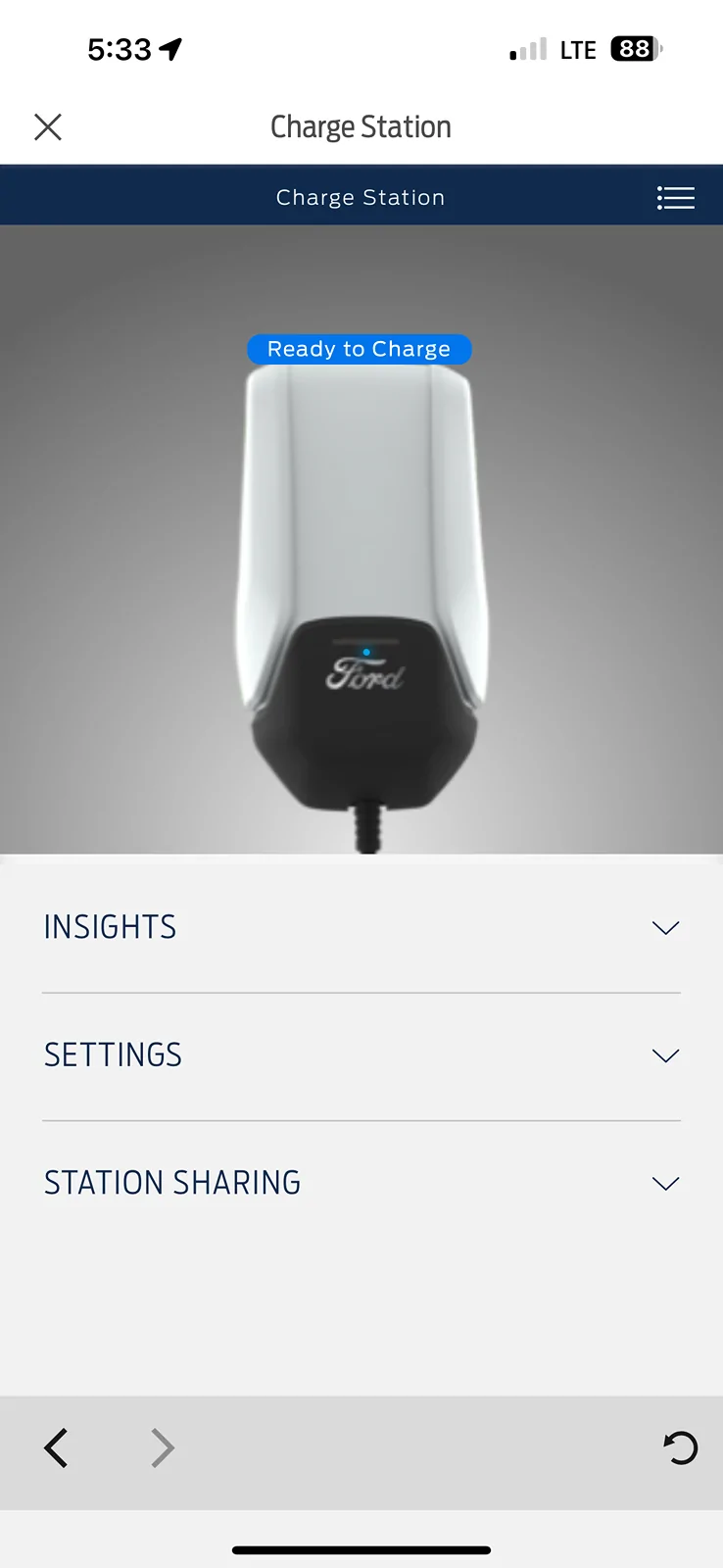

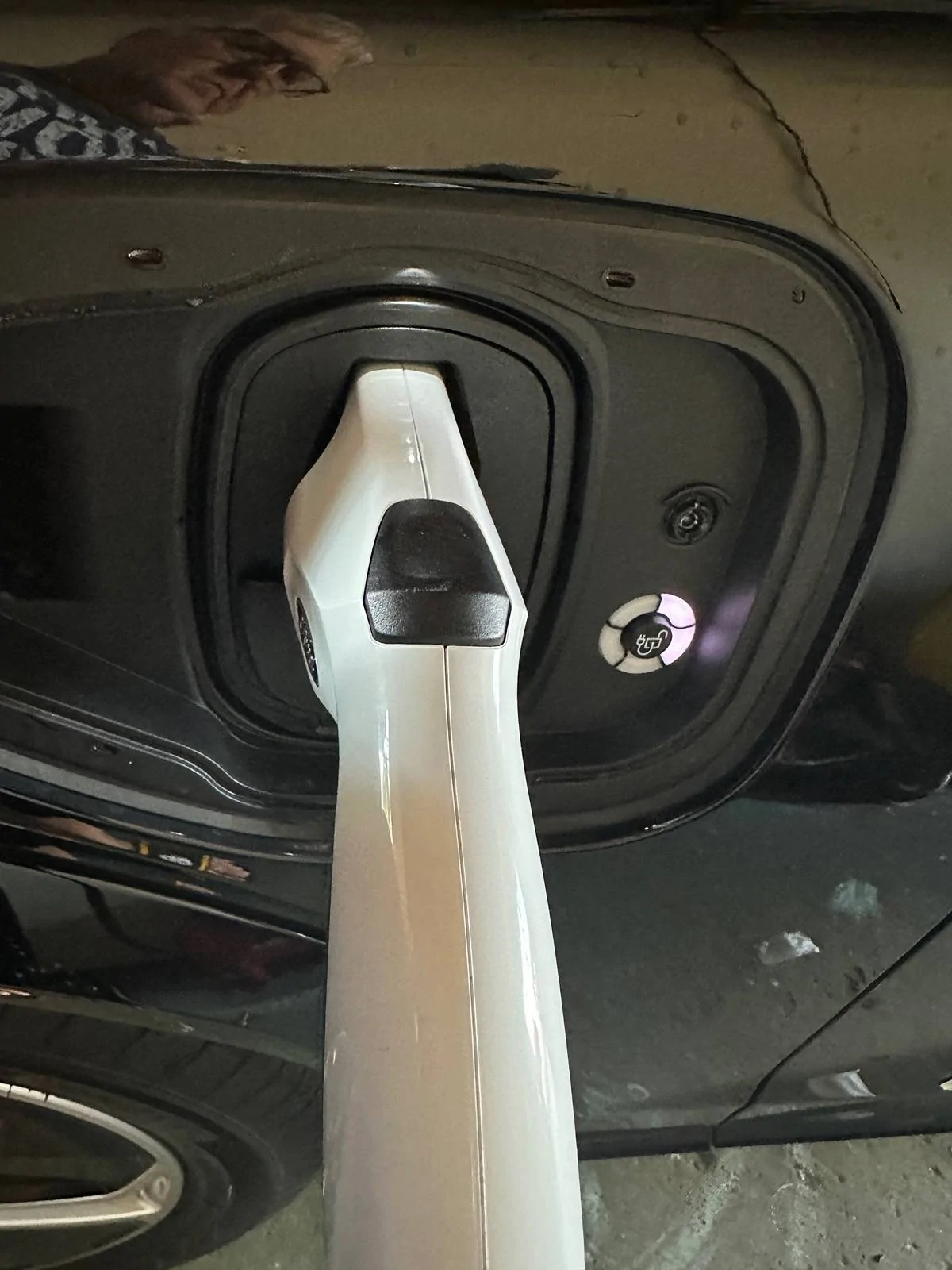

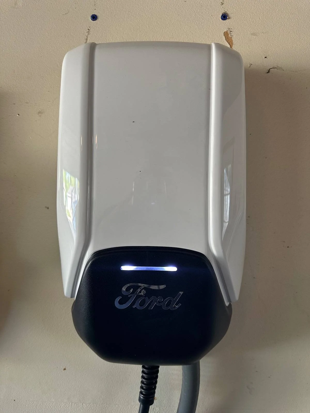

NEWBIE! Purchased Mach-E a few weeks back, and had a Ford Connected Charge Station installed yesterday. I completed the setup, connected the app successfully (twice). The app displays “Ready to Charge“ in BLUE, but the unit is showing a white stripe scrolling from the center to left and right. Plugged in to car, nothing. Any tips? ‘F’ORD!
Thanks in advance

I did that in both the car and the app. No change. It remains at “CHARGE PAUSED”

Your FCCS owners manual says that white, full bar, cycling to middle while plugging in means that "the charge station is connecting to the vehicle, preparing to charge."
Two thoughts come to mind: the installer miswired the connection from the charge cord to the circuit board, or your car has an issue. You can eliminate the second possibility by successfully charging on any other AC EVSE, such as at the dealer, a neighbor's home, or with the mobile EVSE (if you have that).
I see that while light spreading to (or from?) the middle when I plug in but it only lasts a couple seconds. Then it should turn solid blue or pulsing blue, depending on whether the vehicle wants to charge at that time.

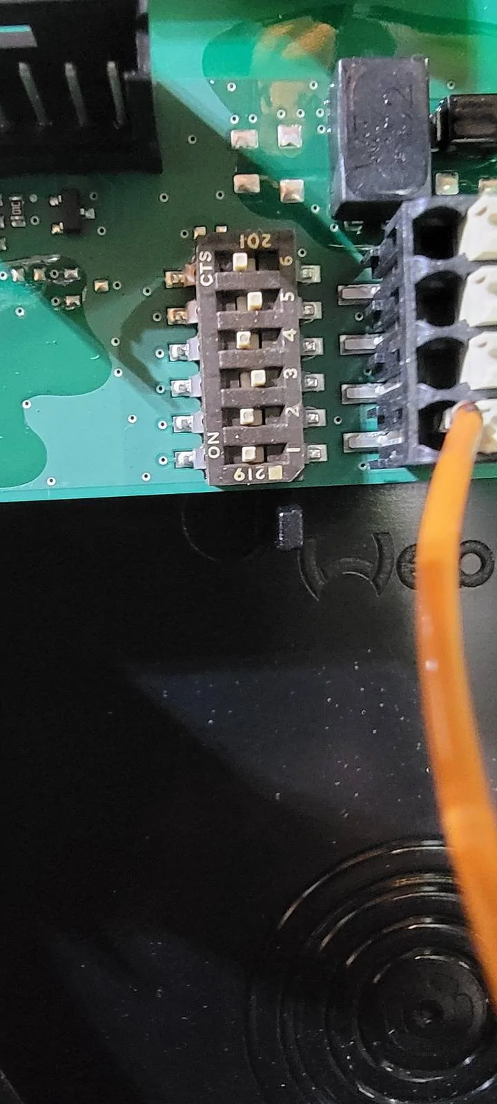

My installer failed to set the DIP switch properly. I turned the breaker off, set the switches per the manual and turned the breaker back on. Worked normal afterward.
Thanks I will take a look at that.

Woah! Thank man! I will see if I can resolve it with the dips!
