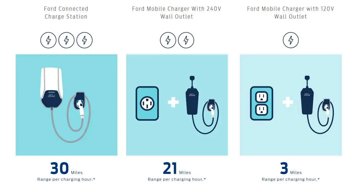

By the way, this picture below is awful, for two reasons. First, it quotes how many miles per hour you will gain in range, but that's particular to your car's battery size, and is impacted by temperature. Much better is to figure out, for yourself, how much YOUR charger delivers in an hour in winter, then in summer, so you can adequately plan your charging.
For most people, if they plug the included charger into a proper 220v outlet, overnight they will be fully charged.
