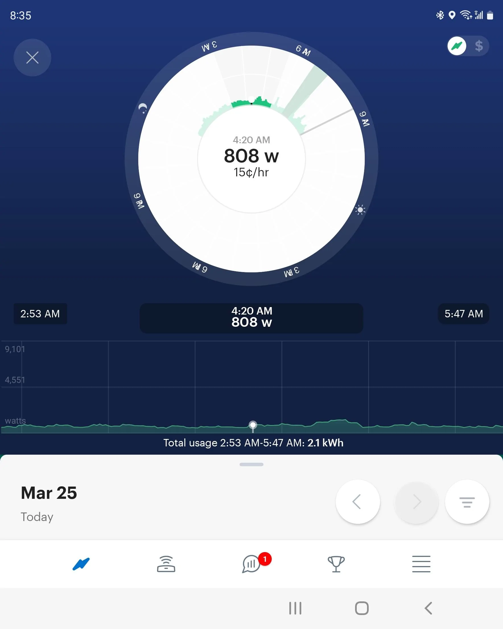

So, this is my first time experiencing the car not charging. Sounds like it happens every now and again according people who have owned their mach e's for a while. I've had mine only a couple of weeks now. Plugged it in last night, lights confirmed it was plugged in, came out this morning and the cabin was warm because it activated my departure time appropriately, but had never charged.
You can see from my DTE energy app, no electricity usage in my 3:00 a.m. to 7:00 a.m. scheduled charge time.
Ford Mustang Mach-E Mach e not charging Screenshot_20220325-083516_DTE Insight

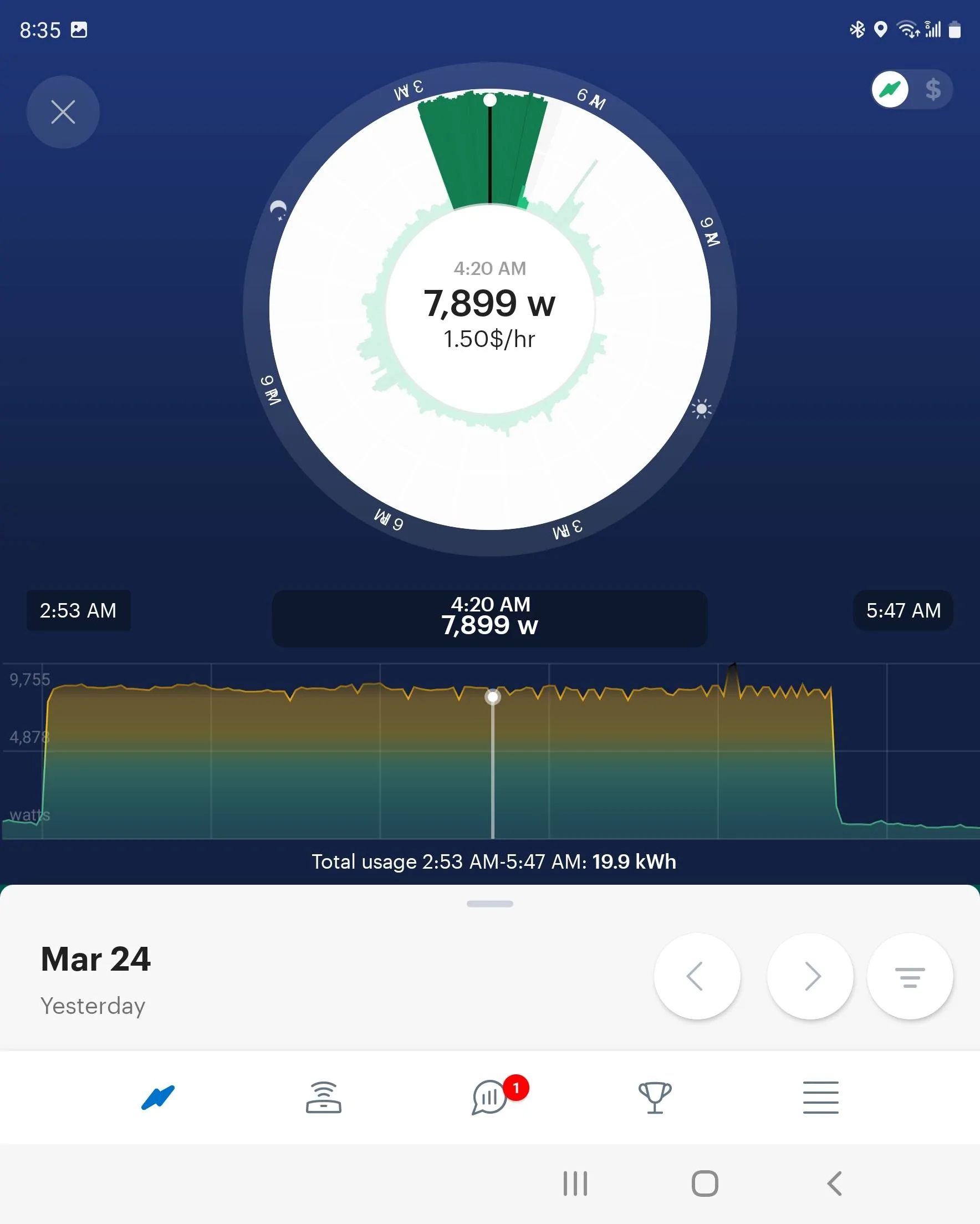

It usually looks like this:
Ford Mustang Mach-E Mach e not charging Screenshot_20220325-083558_DTE Insight

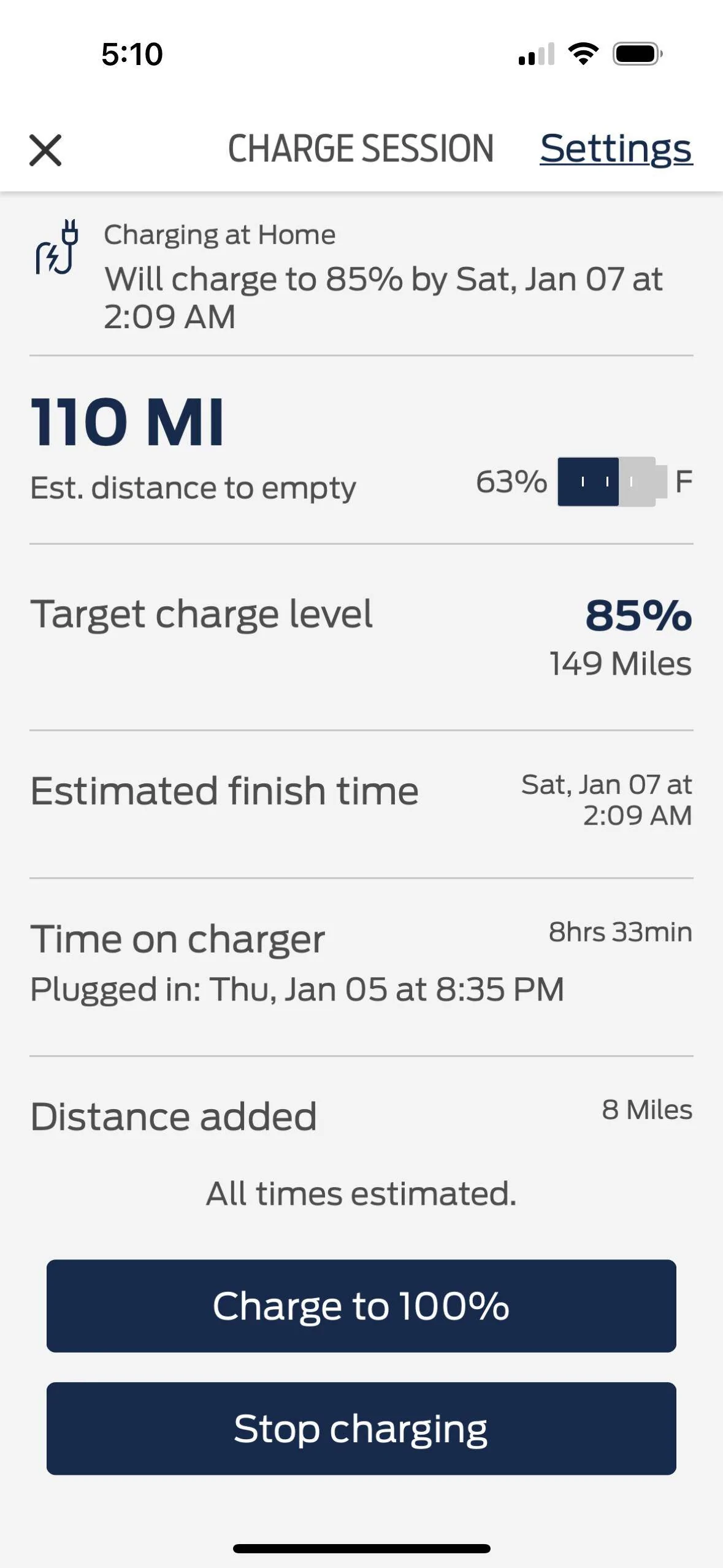

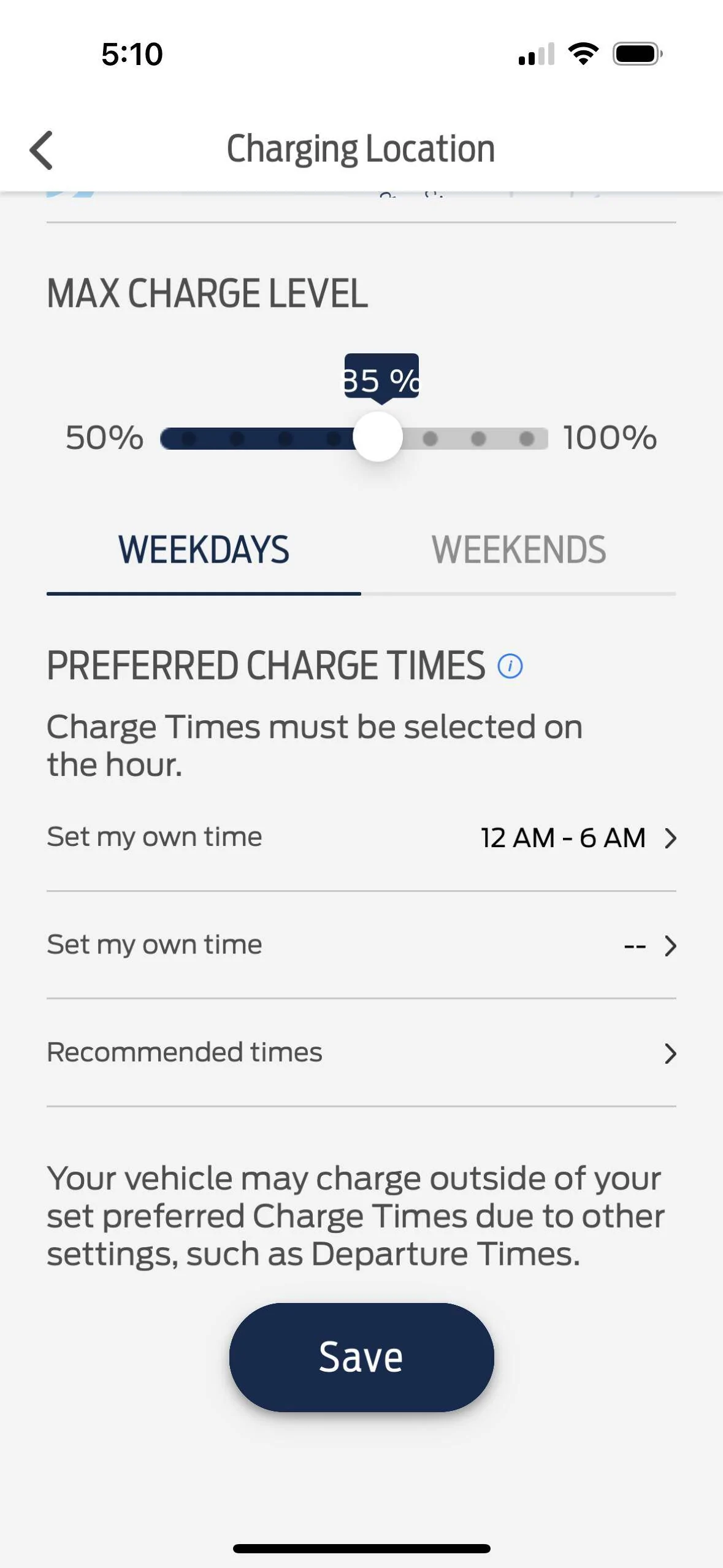

I found this older thread and I guess I’m reviving it. Anyone else having trouble scheduling charging their ā€˜23? I arrived home last night, plugged in, then went in the house to check my charging schedule because I had messed with it because of some public charger issues I had the other day. It was set to charge upon plugging in instead of charge at pre-set times. So…I go into the house and stop charging. Then I re-set the charging time and preference. This took several tries, as it didn’t want to change up the plan. Finally it saved and took. I had set it to charge between 12 AM -6 AM.
Of course I woke up a couple of times in the night…checked the app and it is not charging.
What did I do wrong?!! The car did this the first time I ever set it to charge from the app, and I figured it was user error. Didn’t seem to have an issue again. Now it’s back. ?
EDIT: Right after typing this I went back and refreshed the app. Now it tells me it IS charging and that it will be done TOMOROW at like 2 AM. What the heck??!!
