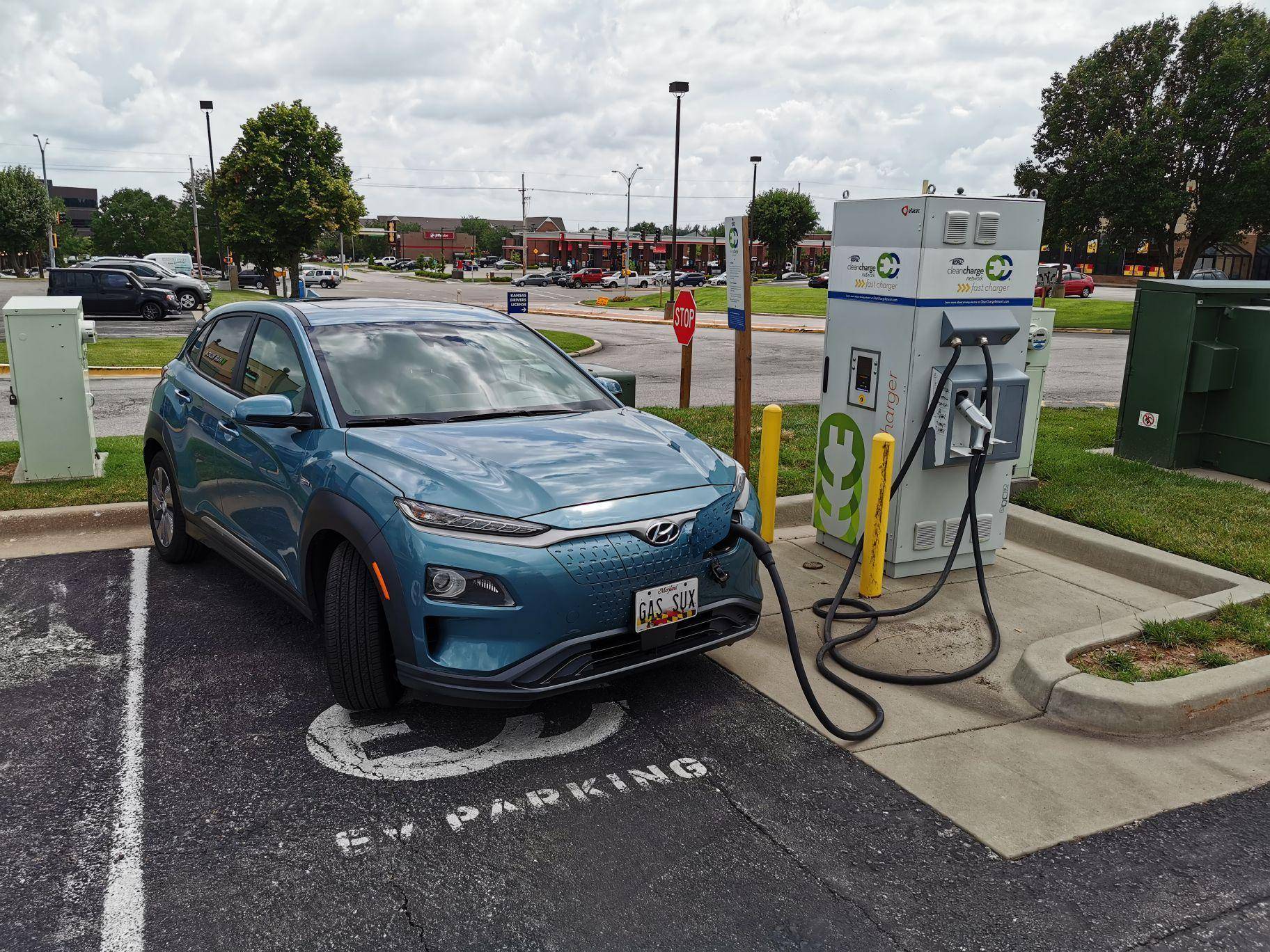

We've now seen multiple reports that the Mach-E won't successfully charge on chargers manufactured by Efacec. One poster reported about the ones around Kansas City, and another in Hawaii. Both contacted the companies that run them and it's a known software incompatibility with some newer EVs (like the Mach-E).
Curious if anyone has ever gotten an Efacec-manufactured charger to work for their Mach-E?
When planning a road trip and counting on certain chargers, probably a good idea to check Plugshare first and look at the pictures to make sure it's not an Efacec. Here's a few examples of the problem machines...

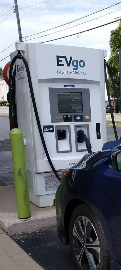

Both I’ve tried are 50KW older models. Forgive my ignorance. When I go by them I’ll take a look at the manufacturer. I got error ā€œvehicle_jinsignal_removedā€ on each. Attached picture shows the charger type (it’s not my car though).
Drove 10 miles to the EA station and am pulling 107kw as we speak to get my charge instead. Pretty frustrated with EVGo!

That last picture looks like one of the newer ones that worked for me. The ones that don’t work look like the one in the second picture of the original post - square and clunky looking. Those are the ā€œefacecā€ units.
