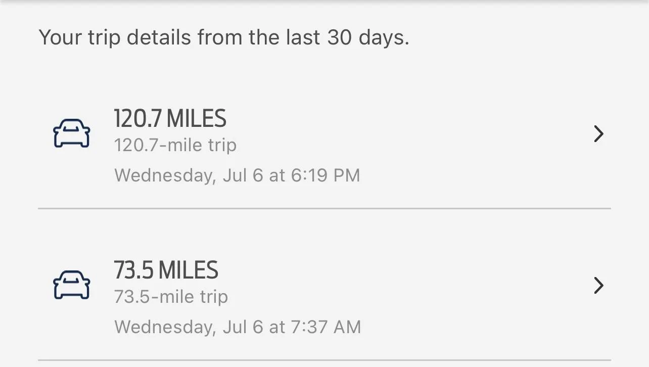

My trip logs are horribly inaccurate…usually 2-3 times more miles shown than were actually driven. This pic was my drive to and from work yesterday, which is about 48miles.
There is a bug that the car will not reset the current trip counters. if you start the car without the break, in accessory mode, first, then use the break to finish starting the car. It will count the trips correctly By resetting miles, time, consumption.
