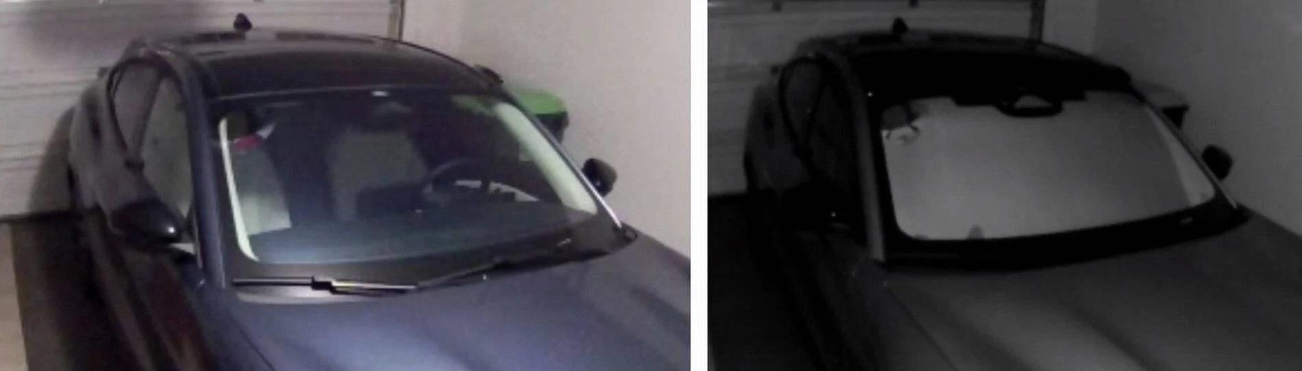

I picked up my Mach E on Friday. After the first weekend of driving it around, my first impression was...VERY cool car. Last night I noticed something though. I have a security camera in my garage because I use Amazon's "In garage delivery". I took a look at the camera last night after dark, so the camera was in night vision mode. It could not see through the windshield at all. I turned on the lights in the garage, and it looked normal. I've read about some people having trouble with the windshield blocking those EZ Pass cards. So maybe that shows up with the night vision camera. I'll find out about the card when I go to work this week...I use an access card for the gate. In the pic below, the one of the left is with the garage light on. On the right, the light is off and the camera is in night vision mode. It looks like I have a sun shield up, but I do not. Just thought it was interesting.

IR reflective glass. It is used to prevent sun radiation to enter the car (will reduce air conditioning), this may also block/reflect the IR light created by night vision cameras.

It isn't strange at all. That's exactly how an IR reflective window should look when using an IR camera.

The toll cards should work through the special glass. Toll cards work at low GHz frequencies, while infrared is transmitted at 300 GHz to several THz. Your TV remote control will be blocked.

Well the part I thought was strange was that the windshield looked like I had a sunshield up when I didn't.
Maybe. Maybe not.
There is a second feature that will influence the transmission of electromagnetic radiation through the glass: the windshield heating. I'm not sure about the US, but all German (European?) MMEs have them. And this feature will also block transmission, albeit in a different frequency range (much lower) than IR.
There are threads on this forum reporting problems w/ toll cards and/or GPS signals.

Too bad the mach-E has its own IR blasters in the instrument cluster for the ADAS driving monitoring.. so it produces its own IR light internally, no need for an external ID floodlight (which will be reflected and block the view).
It is very easy to see how IR light is being produced and reflected, just use the camera on a phone. It is sensitive enough for IR to see the IR light created by various sources.
