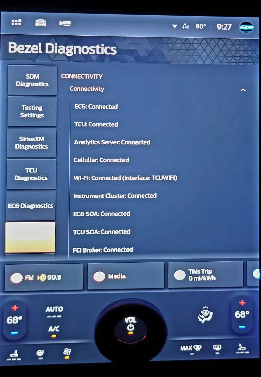

Starting on FM did the trick, Bezel Diagnostics working.
Connectivity check within Diagnostics says that everything is connected.

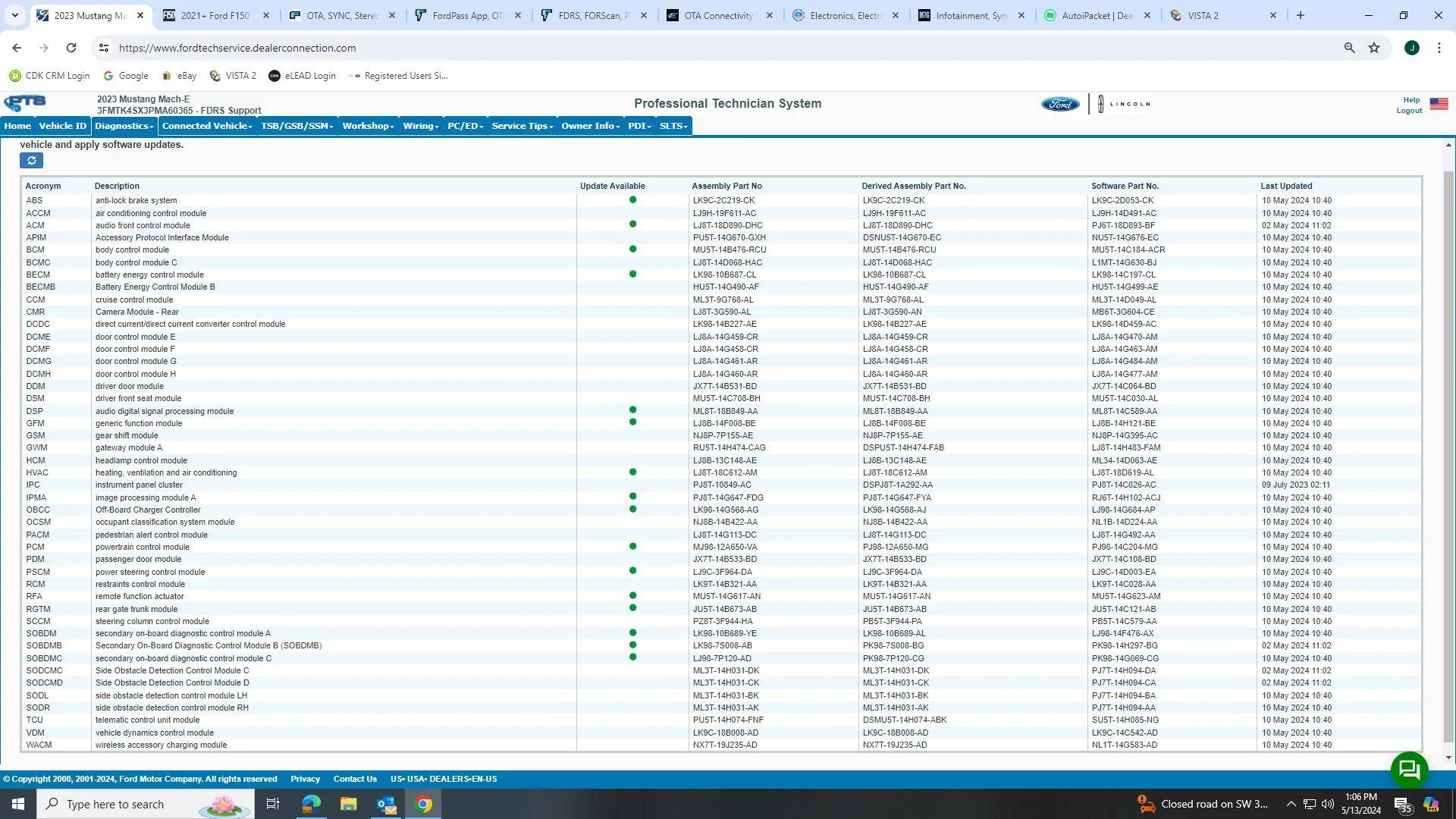

This is what PTS shows, but in reality there are mode than these. Because you have a 2023 and are on Sync 23031, this may be the latest Sync version available to you until Ford releases more updates for the APIM/GWM/TCU/IPC for your car. I would need to check what FDRS shows pending for you, but that would have to be later in the evening when I get home. Remind me if that is the list you want. However, I would maintain low expectations if you are thinking of asking the dealer to them.
