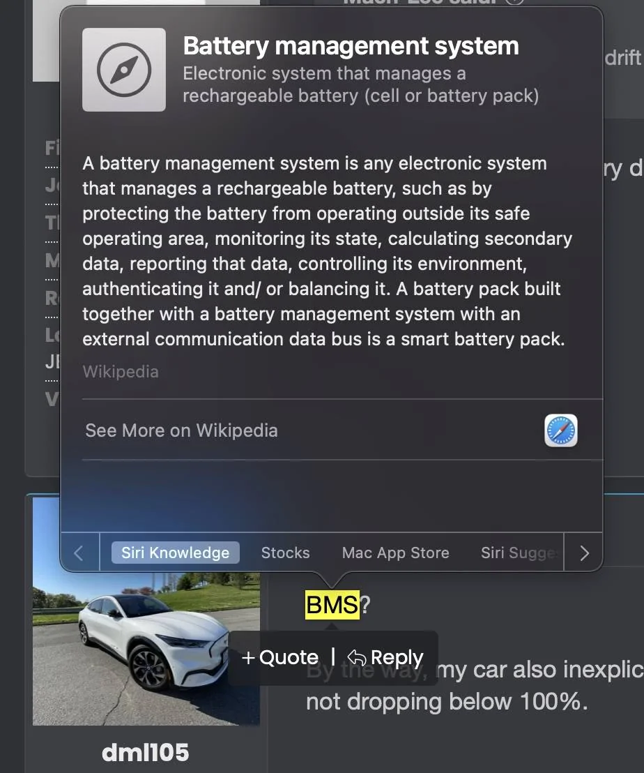

BMS?
By the way, my car also inexplicably charged to 100% last night, and I also go all the way to work (7 miles) with it not dropping below 100%.

BMS?
