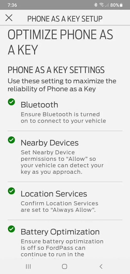

worachj
Jan 13, 2023
241
181
Eagan, Mn USA
2023 MME Select AWD Rapid Red Metallic (03/10/23)
What does your optimize phone as a key settings look like?

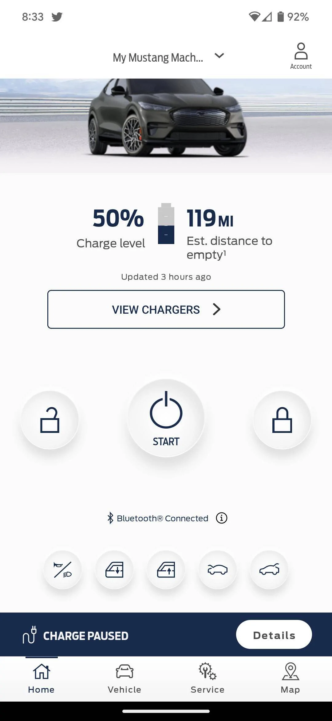

SalsabyJake
Jake
Jan 24, 2023
94
36
2023 Mach E Premium
Musician
I had the same problem, and after removing the PAAK completely and re-setting it up, it started functioning. I think it has to do with correct pairing of the phone with FordPass. The Bluetooth connection is 5 numbers followed by MACH E. I had that but it didn't work. So I deleted that Bluetooth connection, removed PAAK completely and started over and it worked after setup. I just tried it again - walking up the car with no key. After I "woke the car up" by pressing a door button, it connected and unlocked the doors, all icons were not grayed out, and Bluetooth was connected. FordPass 4.28.0
