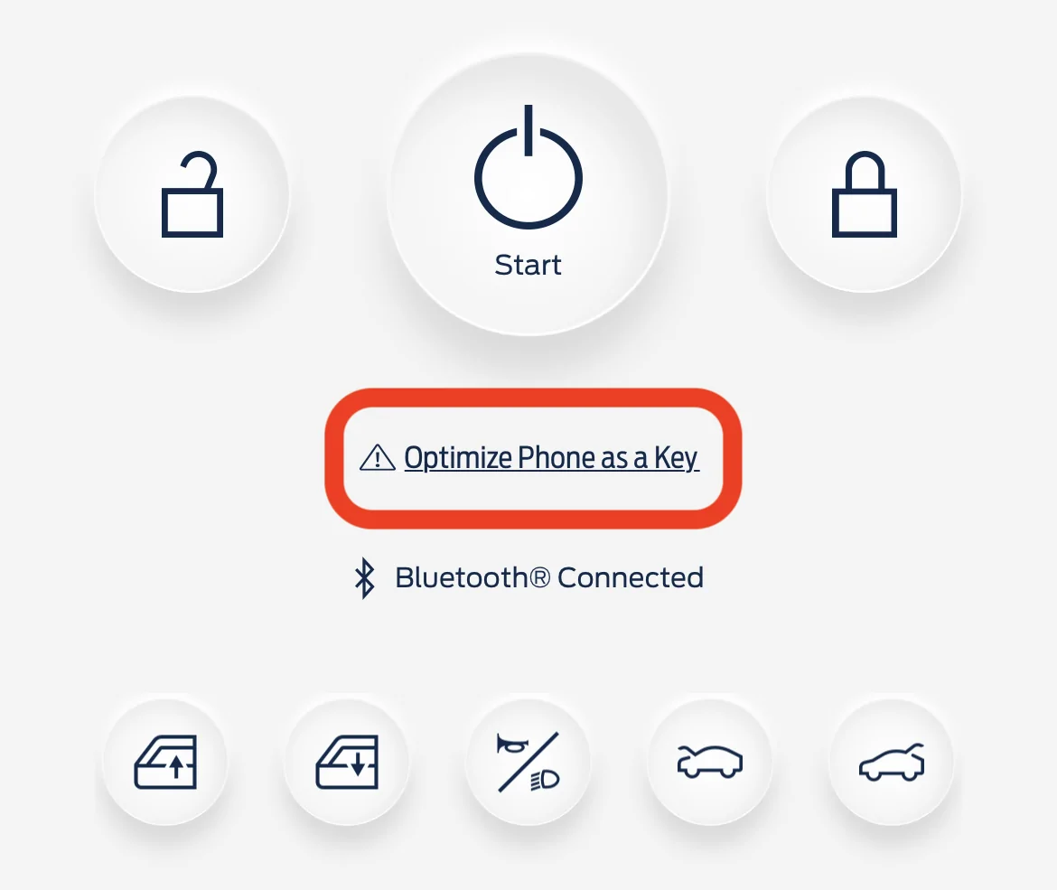

If this is showing, follow the instructions to fully optimize PAAK so it runs in the background:
Ford Mustang Mach-E PAAK on Approach? img_1833-png

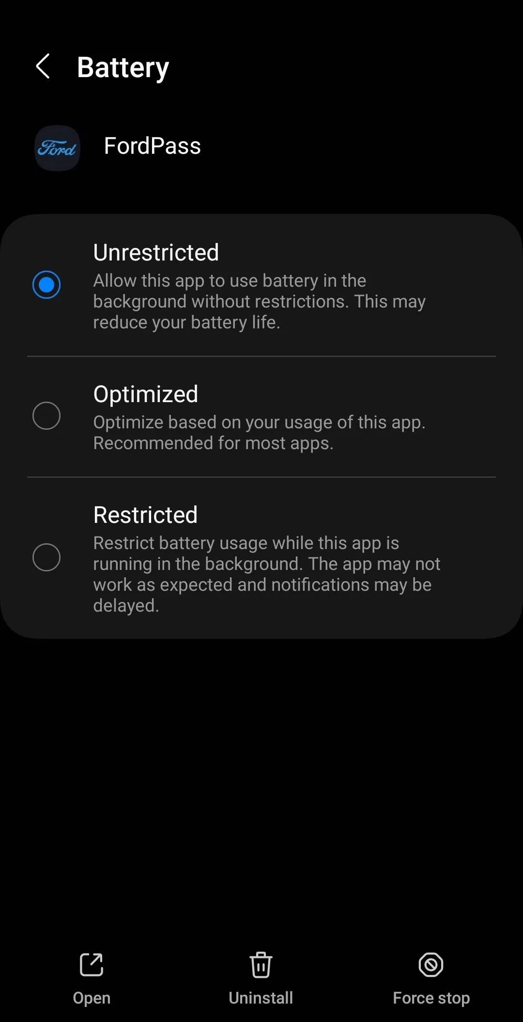

Make sure you open it once after a phone reboot to ensure it's running.
Also, make sure this setting is on.
Ford Mustang Mach-E PAAK on Approach? Screenshot_20230714_082501_Settings
