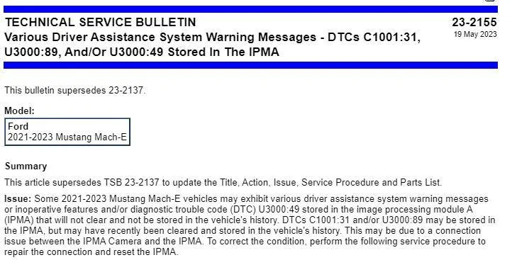

Looks like you have the open FSA for the parking brake harness that @generaltso mentioned.
Ford Mustang Mach-E Parking Brake Fault 1689610710872
ABS DTC being given:
Ford Mustang Mach-E Parking Brake Fault 1689610748433
maybe have this one done too:
Ford Mustang Mach-E Parking Brake Fault 1689610852495
