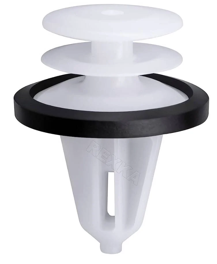

A few of the snaps broke or came flying off never to be found when removing the drivers door panel.
They are the classic ford clearish plastic, however they have added a rubber gasket onto them. What’s the part number for these? No visible writing of a part number on them I could find.
Also there are some snaps they look the same only yellow in color and used for the rear trunk plastic panels. Anyone know the part number for these?
Ford Mustang Mach-E Part numbers for clear and yellow plastic panel snaps. IMG_8533

Those white pins for the interior door panels come in a pack of four and the part number is W713297-S300
The yellow pins for the rear cargo trim panels also come in a pack of four and the part number is W721069-S300
I have some extra you can have if you only need a few.

Thank you. I couldn’t find it in the exploded door picture. I think I may have found an OEM manufacture that makes them for ford. Once I have them in my hands I’m going to compare them to the actual ford ones.
