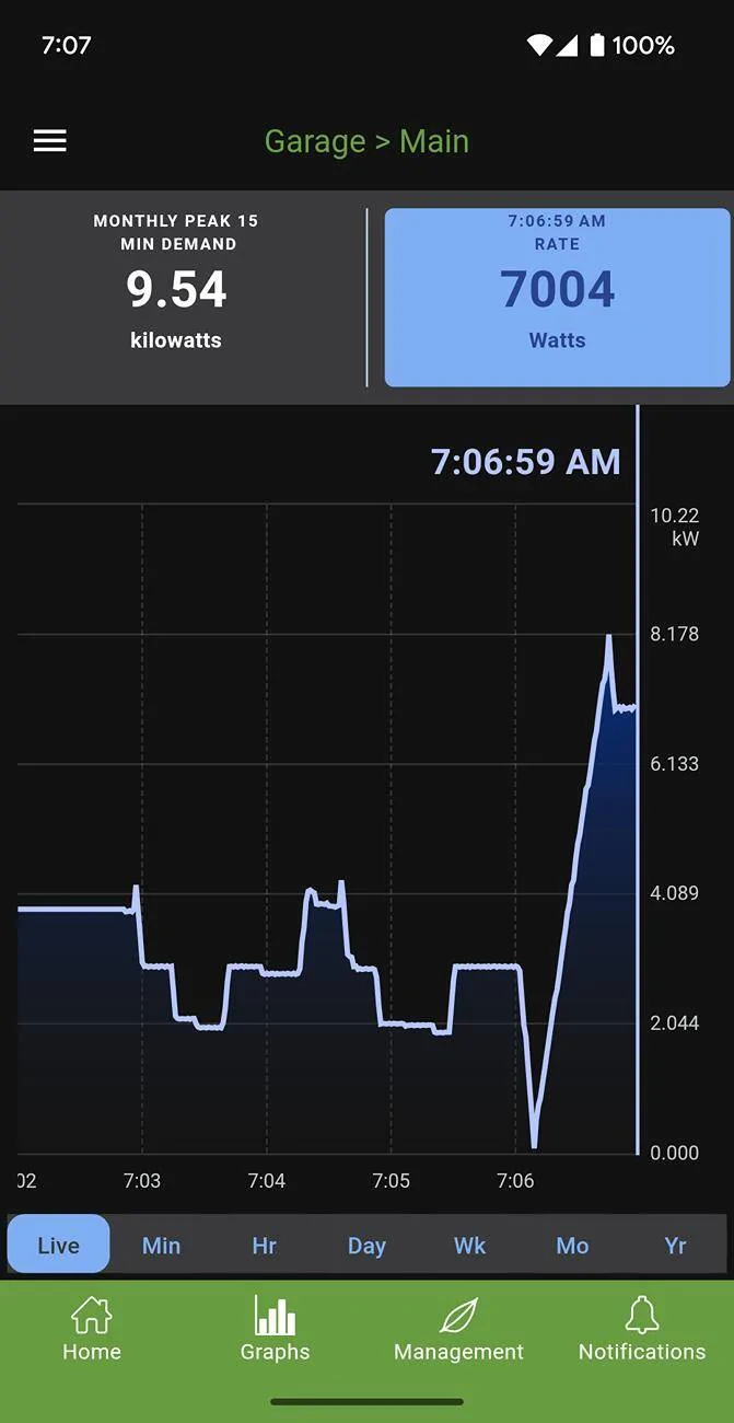

This happened to me not 5 minutes ago. Got the notification from FordPass but my car is not warming up, my L2 charger shows no usage increase. My best guess is a bug in the app.
EDIT: I take it back. It just flipped on. My scheduled departure time is 7:40 so it might have started the preconditioning and sent the notification by mistake.
