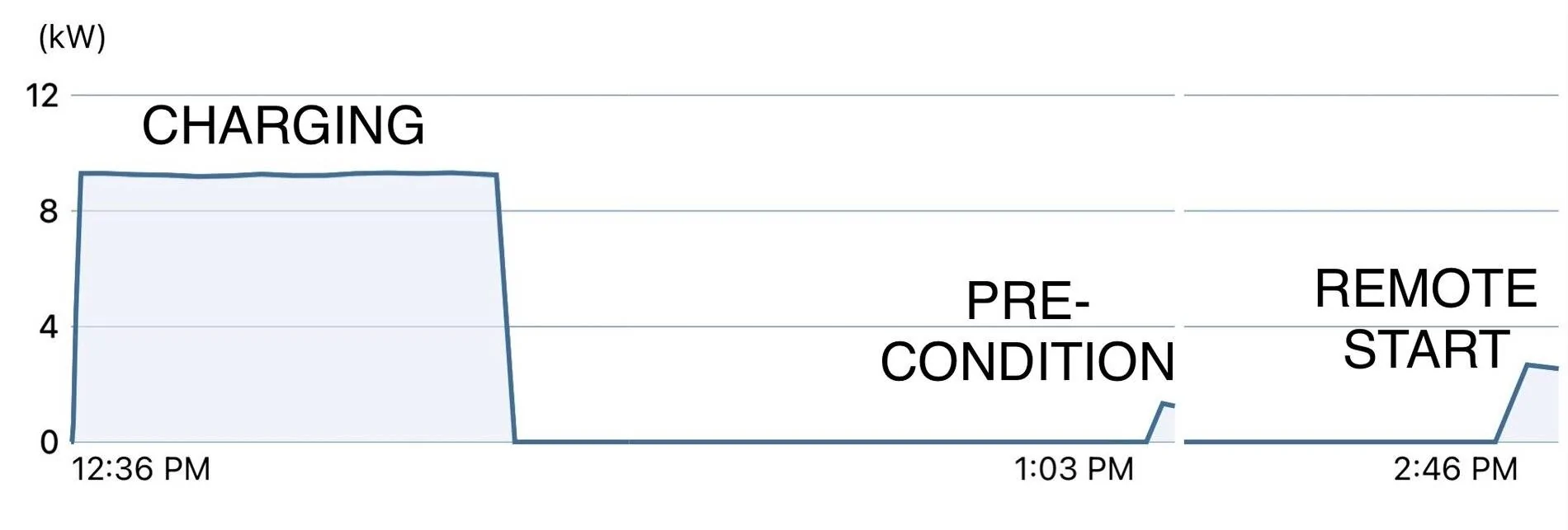

My remote starts pull from shore power if plugged in.
Did a test the last few days. I was wrong, remote start and pre-condition both pulled from shore power. Remote start actually pulled more weirdly.
What does it do if you remote start or schedule a start time outside of scheduled charging times?
That is, if you set it to charge overnight from 11pm to 5am, and schedule a departure for 8am, will it still draw power from the EVSE?
Yes. It will draw from the EVSE. At least mine does. ??
Yes it will. That is actually 3 screenshots stitched together. The charging was overnight. The departure and remote start were in the afternoons.
What were the cabin temp settings for the two events? Over the summer when I was using Cool the draw was much greater than it is now that it has cooled down and I'm using Medium. I think I still have remote start climate set to Auto but I'll have to check.
I noticed that too. Departure was set to Medium, Remote set to Auto. The auto was probably trying to get it warmer.
How did you create that graphic? Do you have a version showing the complete X-axis for Pre-condition and Remote-Start?
What is "shore power"? Wall power?
That was pulled from my ChargePoint app. I composited them together with photoshop. I don’t have a full graph, but it doesn’t look much different on the other side, it drops rapidly. The thing I haven’t tested for is climate temp. That will cause the usage to vary widely. Both cabin climate settings and exterior temp needed to condition the battery.
Yes shore power is wall power.
