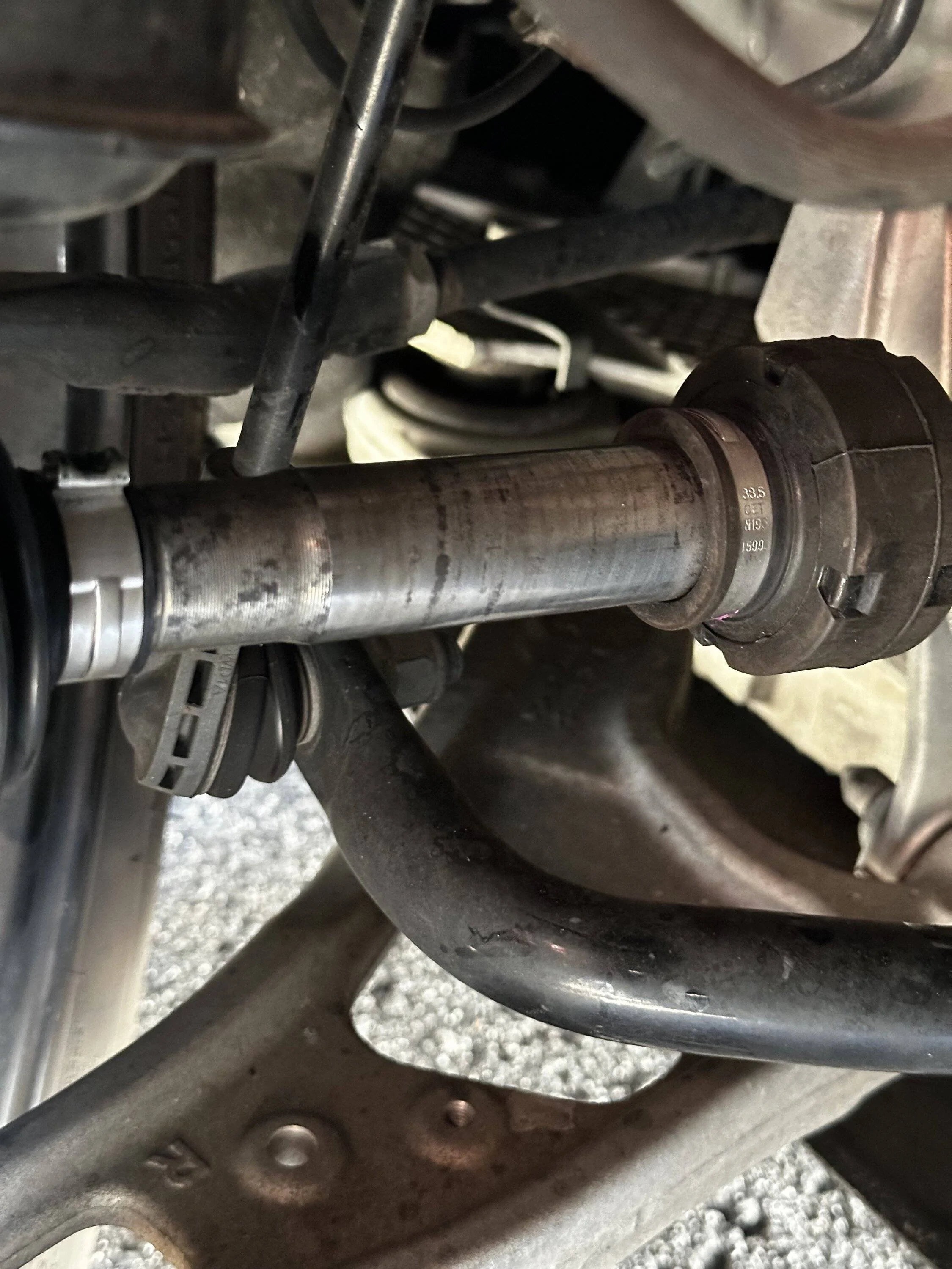

Is this a single popping noise or a sequence? I used to have a sequence of clicking noise when doing sharp turns in slow to moderate speed. There is an internal service number for that. I can get that when I’m back home. Basically they changed this shaft on one of my front wheels.

Mention the SSM50513 - about replacing the front axle. It usually done one at a time as needed.

My ‘21 GTPE does this too…when I turn the wheel fully (like in a dead end turn around strees). My ‘21 First Edition does not do it.
I just assumed it has something to do with the suspension, as I think that and the wheels/tires are the only real difference in the 2 cars. I’ve never asked my service dept about it.

The next step is to schedule service with your dealer. They just “grease the wheels” to make it easier for you.
